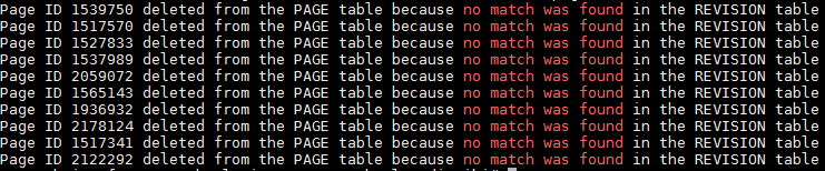

So the wiki main page states "1,886 articles on this Wiki" and the old temlib clone says "1,124 articles on this Wiki". I get 2957 pages in the database. But not sure why such a huge discrepancy. Though likely the page count on the main page is bad anyway. But with multiple revisions of some pages that *could* account for it.. but I will keep digging before actually doing the delete.
So looks like the revision table has 12353 articles. But that is revisions of the same page. So that's like every page has been revised 10 times kinda thing. So not really worried about that count.
I will do a debug dump of the 2957 pages and see if anything looks off, but possible the main page count is simply wrong I guess.
I think this is likely the discrepancy.. All the images are being classed as a "page" as well.
EDIT2:
Looks like the odd spam post might have got though, but kinda expected the odd one to still be there anyway.
Page ID 1281 exists in the REVISION table Lengame
Page ID 1207 exists in the REVISION table Leonardo
Page ID 1102 exists in the REVISION table Lethal_Xcess
Page ID 1077 exists in the REVISION table Level_Codes
Page ID 3881 exists in the REVISION table License_Status_of_commercial_software
Page ID 57143 exists in the REVISION table Lifetime_Top_5_Unlimited_Online_Drive:_How_Start_Off_An_Web_Business_On_A_Shoestring_Overall_Wedding_Budget
Page ID 1139 exists in the REVISION table Line_A
Page ID 1356 exists in the REVISION table Line_of_Fire
Page ID 1088 exists in the REVISION table Linux_Disk_Commands
EDIT3:
Onward with the page table cleanup :)

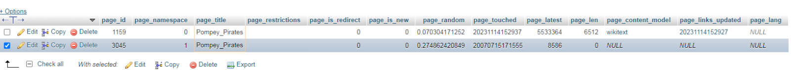

So the Pompey_Pirates page error is puzzling. I've traced it right though the database and all the info is there. But the ID its chucking out as the not found error, is nowhere near the correct page ID. So I don't know where its getting #5533364 from! I've restored the original database and that's the same, so (thankfully) its nothing I have actually broken!
ahh found the bugger!
Old vs new DB. Don't know how that ended up corrupted. But as the server was seemingly running with bad RAM.. :shrug:
