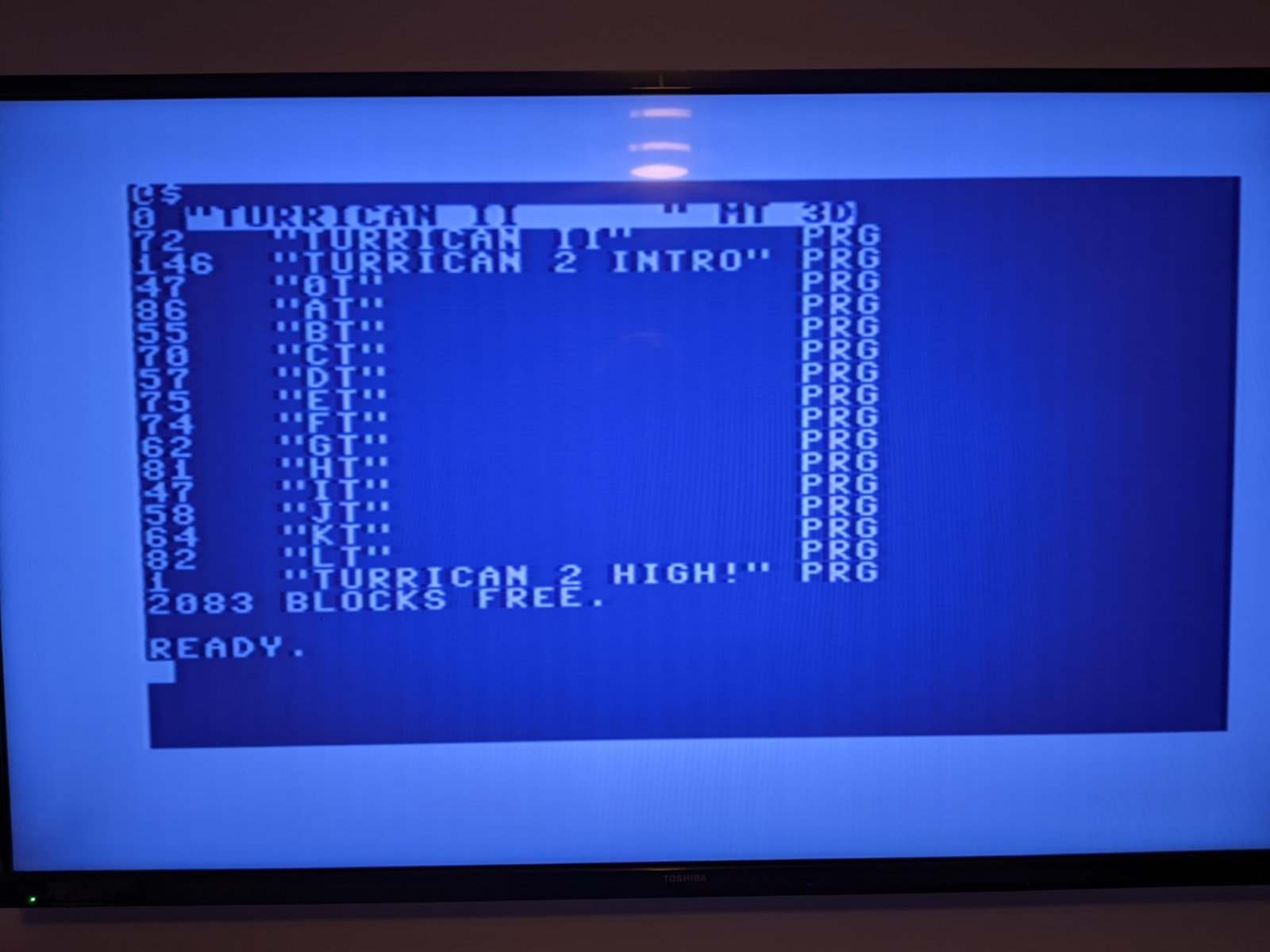

I bought a kit to build a 1581 disk drive replica - via a German forum. Pretty reasonable compared to the cost of buying a used original.
I already owned a suitable PSU and a spare Amiga 3.5" floppy mechanism to use with the kit.
Anyway, the kit arrived on Friday and I set about building it on Sunday evening, it took a few hours and was quite straightforward.
I did some simple checks to make sure I hadn't dead shorted anything before powering it up.
It worked first time - amazed that I didn't mess anything up.
There's probably very little reason to own a 1581 these days, my 1541 U II+ can emulate one and mount .d81 disk images, but I just 'wanted' to do this as I remember dreaming about owning one when I was a kid.
Some kind souls out on the internet have converted a lot of multi-disk games to .d81 format, this means that there's no need to do any disk swapping, even if it would be just virtual disk images.
The first thing I tried with the drive was one of these images of Turrican II - I used an old amiga floppy with greaseweazle V4 to write the image out.
The built drive...
The drive electronics responding to a status command
Turrican II disk directory
The built drive...
