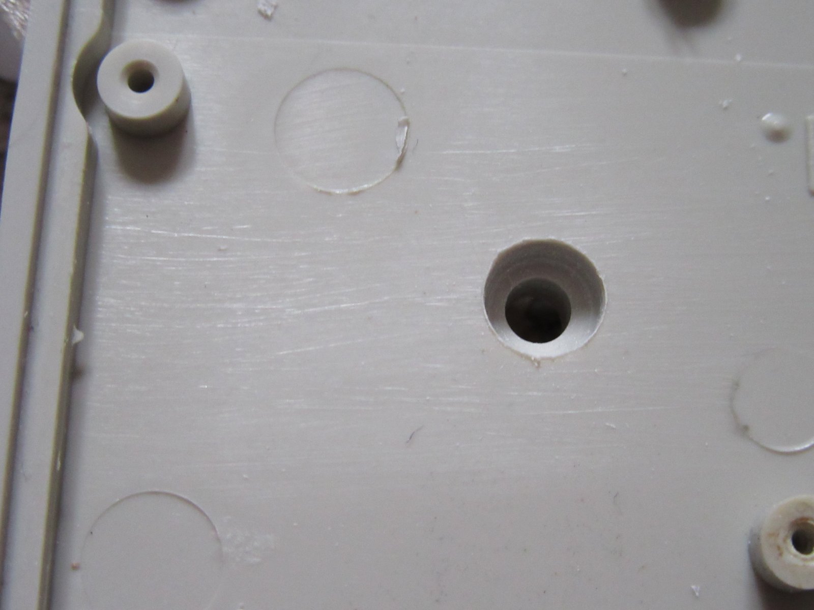

So took the keyboard apart AGAIN, as found I had the later LED mod boards made already. So now the green LED staying on a bit is solved!
I think the PCB is to bit to big to fit where I have it.. probably will have to be stuck on the back of KB PCB and run the 3 wires to the LED instead...
Had to drill the plastic down a bit as the LED legs overhang the LED body :roll:
Bodge wires - check.
Bodge tape - check .
My work is done :)
