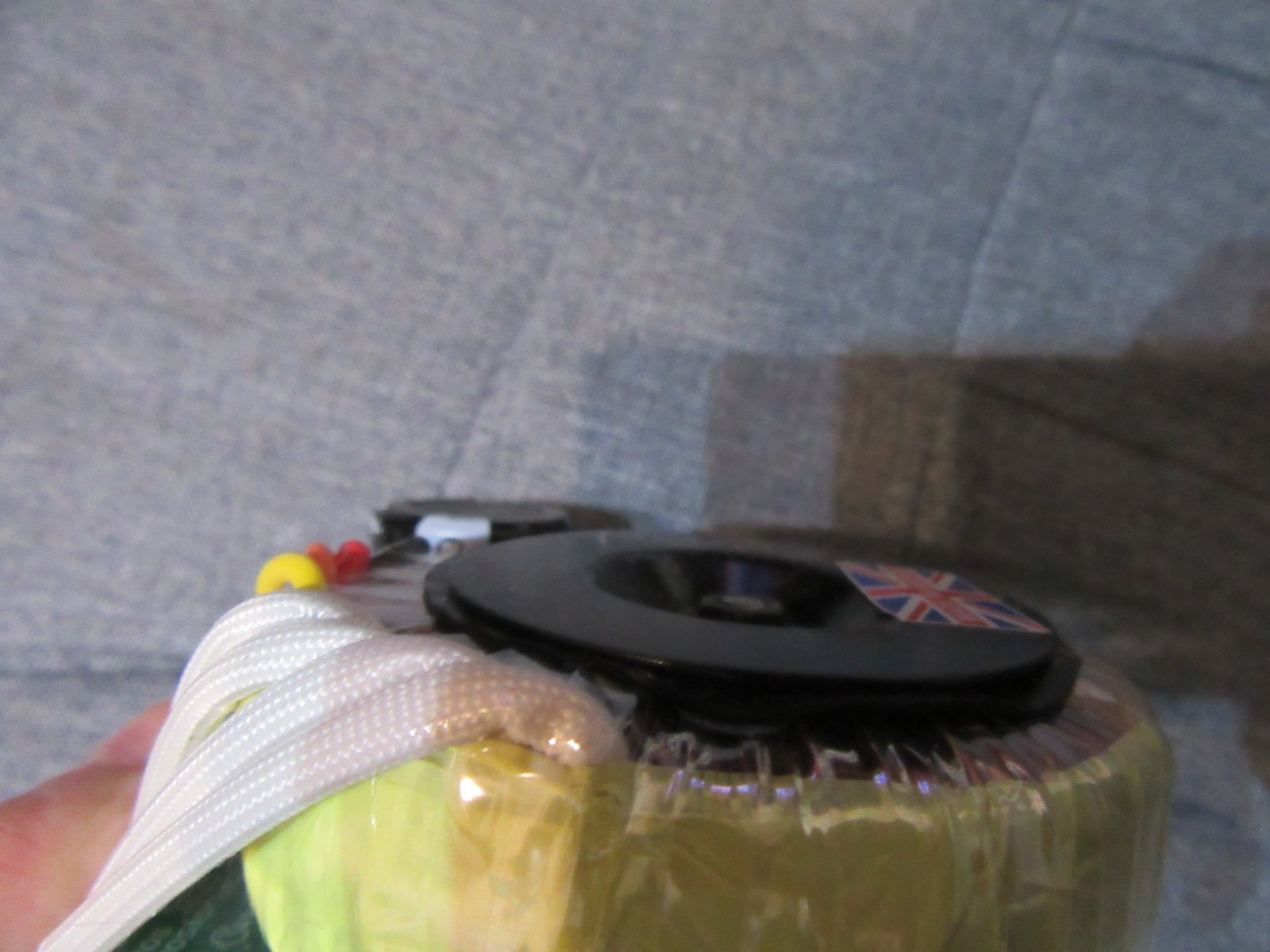

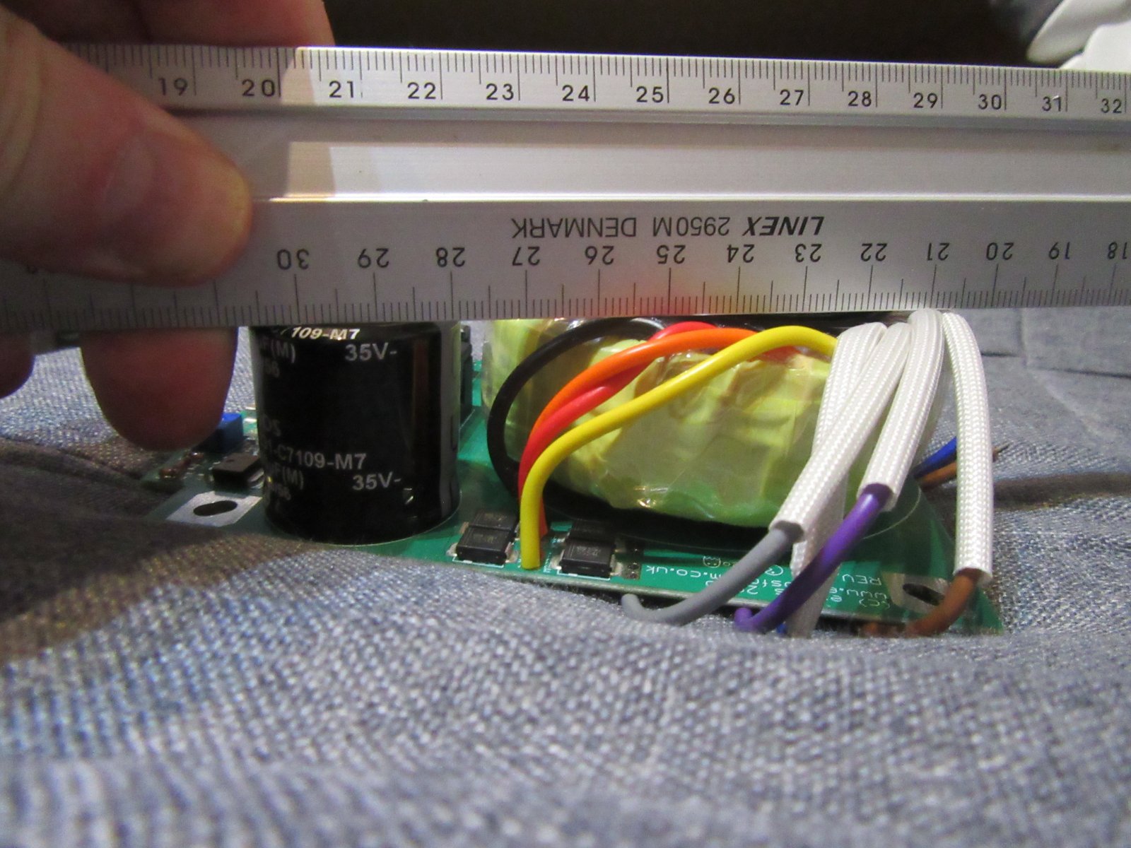

Is anything on the PSU higher than the large capacitor ? The large cap is 30mm high which is exactly the same height as the original PSU. The transformers wires look like may be sticking up slightly wrong, but that shouldn't give you the height difference you seem to have. All wires on top of the transformer are supposed to be routed downwards around the outside of the transformer rather than above it. But even so, you seem to have lost more height than that somehow..

I know this may sound like a lot of faff, but can I suggest you take the mainboard out othe the case and shield, pop it on a flat surface and measure from the flat surface to the top of the PSU when sitting correctly on the board (A bit like @exxos did but not from the cap, from the surface it's sitting on) and take a note of the height.
Do the same with the old PSU and see what the difference is. You will need to be sure the lugs are in their slots in the mainboard for both measurements.
There is clearly some kind of mechanical issue between the case/PCB and PSU and the only way to get a proper read on it is to measure without the case IMHO.

That doesn't make any sense. If you lowered the bracket, the mains input connector and switch would no longer align to the back of the case..mikro wrote: 12 Oct 2026 00:50 Thanks to help from a talented friend, we could lower the bracket's legs so it fits again but I was rather disappointed to see this. :-(
I just measured the height of my original Falcon PSU, and it's actually about 2mm taller than the exxos PSU was designed to fit to.
