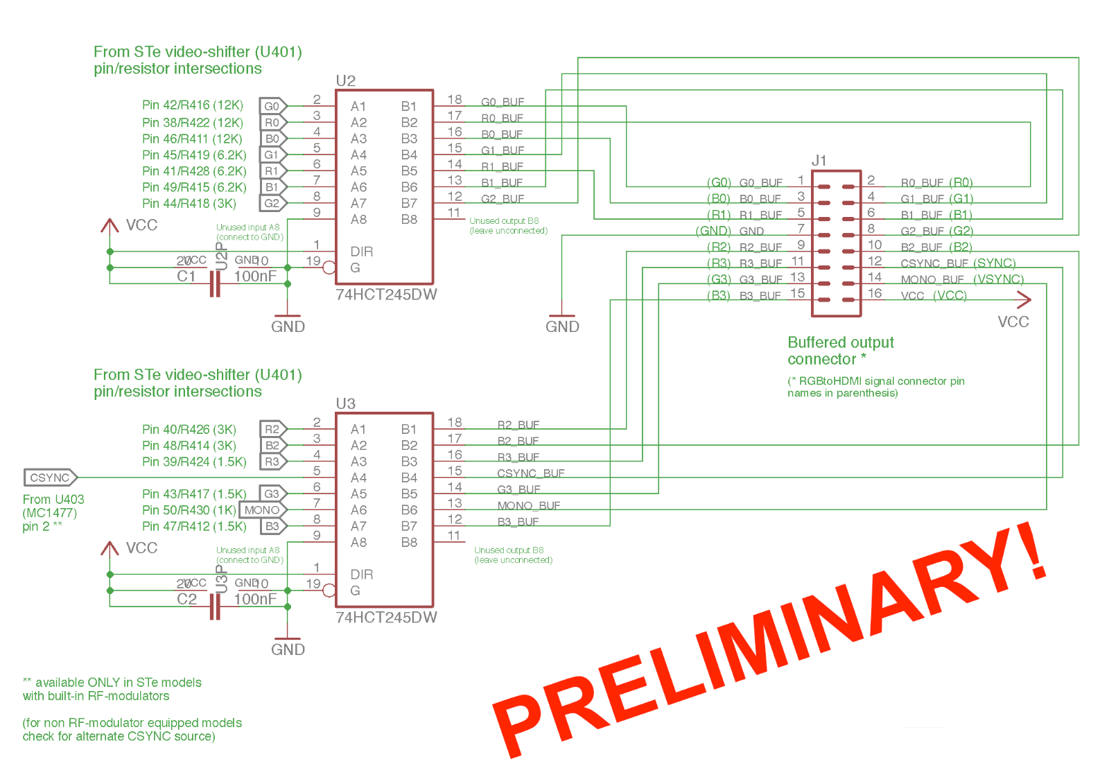

That page is one of my sources as well, for the buffer I'm working on. It's the only one I've found describing how to add a buffer in an STe (if you don't want to start from scratch that is).
Unfortunately there's a mistake with the modified Amiga buffer PCB (shown near the bottom of the page) where the 3rd pin (marked in pink) should actually be the 4th pin. The author is aware of this. The schematic below should be correct though.
By the way, I see you take +5V and GND from the STe motherboard. Does this power up the entire RGBtoHDMI setup including the Raspberry Pi Zero, or do I need to power the Pi Zero separately using its USB-Micro power connector?
Here's a schematic I made of the Amiga 12-bit buffer, modified for the Atari STe.
I hope to complete it with a PCB that'll fit underneath the power supply (or some other place near the video shifter PLCC chip) with the connections routed appropriately, connectors added etc.
NOTE: If you want to connect the IDC cable directly to the RGBtoHDMI/extender board (i.e. you don't want to add the buffering circuitry in between) it should be a matter of just bypassing the two 74HCT245 buffer chips (i.e. A1 connects directly to B1, A2 connects directly to B2 etc. of each chip).
Atari STe 12-bit buffer 0.10.1 schematic.png (282.56 KiB) Viewed 143 times
:!: I've triple checked the connections in the schematic but haven't actually built and tested it, hence marking it as "preliminary".
:!: If someone finds an obvious (or not so obvious) mistake, please do tell! I'm just a hobbyist, still learning :)
