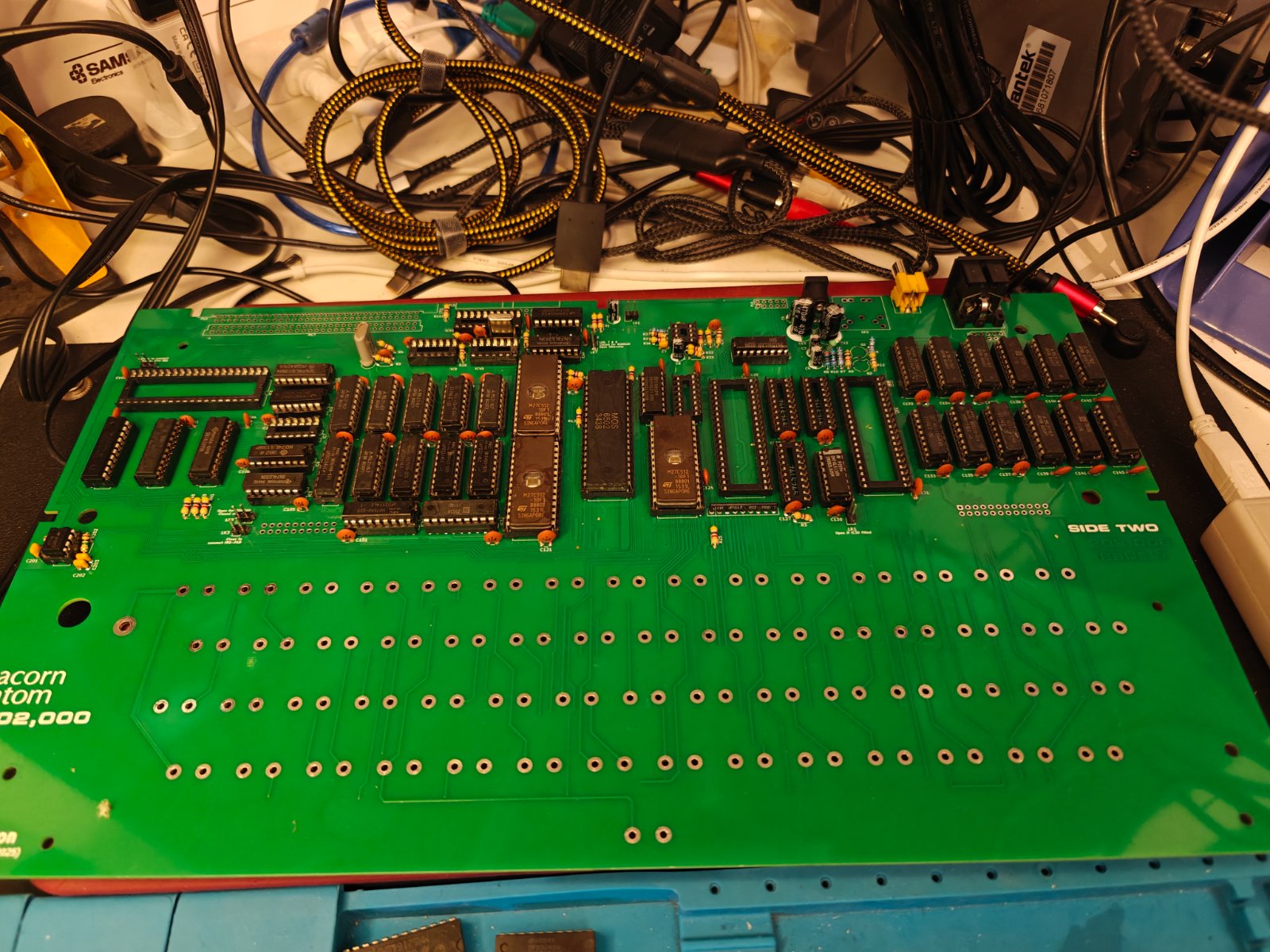

Re: Acorn Atom Replica build
So, progress today:
And I was about to get going on stripping this for the switches:
Only whilst trying to unscrew the collar to change to a larger tip, the plastic support for the iron tip broke on the desolder gun....
I've fixed it (Hopefully) as I had my old spare gun left over for bits, but it's set me right back. Very annoying.
- Posts: 15621
So, a big day for the Atom today. Whilst I'm waiting on the other parts I need it's getting it's keyboard
I started off by finishing desoldering the BBC B keyboard and harvesting then cleaning the keys:
And from there started installing them according to images online and the silkscreen on the board:
It's very reminiscent of installing the keyboard on the OSIO 600D in that there are pin holes for the switches, but there is enough play for the switches to move around, so I spent a lot of time trying to get everything aligned as I went.
I finally finished and I think it looks great:
Of course the BBC is missing some of the Atom keys, so I've done my best to replicate, however I had to use the function keys for Return, Repeat and both Shift keys, as the Atom doesn't use full size Shift and Return keys and Repeat is not a key on the BBC. I now have spare BBC B key switches too, which is always handy.
I quite like the look of the red function keys, I think it looks like a halfway house between the Atom and BBC
Rather brilliantly the whole BBC B space/stabiliser bar fitted exactly as it did on the BBC and works perfectly.
