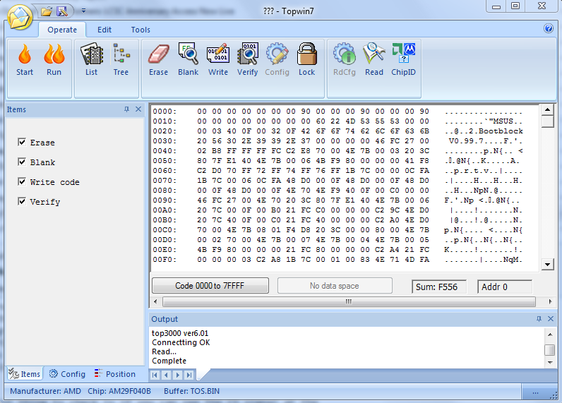

I found my programmer can read the flash..
Verified as the latest one here https://www.uweschneider.de/en/downloads.php
release_990708
So thats not dead at least..
So the question is why is only D0 pulsing at this point.. Problem is thats a "boot block" so I assume its not going to be booting TOS for some time later.. that makes it hard to tell anything.
I guess I could remove the CPU and hardwire for the address lines low to make things easier to diagnose on the databus.. But at this point don't really know what the databus is actually supposed to be doing..

I sent a email to Uwe asking of my flash sounds normal.. but only D0 toggling sounds stange. But if that is the problem, 7 stuck high databits somewhere isn't going to be pretty unless its the CPU..
I guess I could remove the CPU, try forcing other databits low via a 1K resistor to see if they change or not..
