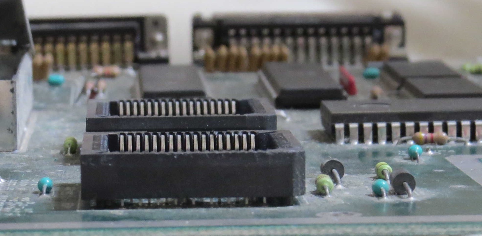

... there are Atari type PLCC sockets 8.3mm high and 9.3mm high. You can see the difference but whether it matters that much is the question?

I guess that 1mm matters, because I *can* close the machine with the keyboard fitted, but it doesn't lay perfectly as it should.

I can send you two 8,2mm ones you have a desolder station ...?
... but I can send it only as package for 16,- Euro without Tracking.
Ask BEST, he as golden ones or Exxos.

frank.lukas wrote: Sun May 21, 2023 12:31 pm I can send you two 8,2mm ones you have a desolder station ...?
Thank you very much Frank.
I have already ordered one from exxos and will check it as soon as it reaches me.
If the socket is still too high, I will buy yours.

Socket removed.
Now waiting for exxos' one to arrive and perform the transplant.

HigashiJun wrote: Thu May 25, 2023 11:11 am Socket removed.
Very neat job :thumbup:
Socket transplant, why does this sound like some sort of TV series :lol:

@exxos Thank you !
By the way, the ThunderStorm team is seriously working on the socket issue.
Hope they will have a workaround soon.
