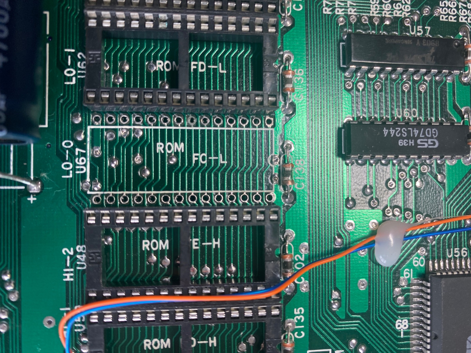

I may have stumbled onto something just now as I spent some time looking for broken tracks etc.
I noticed that a couple of the ROM sockets looked like there was corrosion around a couple of the pins.
I removed the ROMs again and this time pin 17 of Hi0 and pin 7 of Lo0 broke. Doh!
However, given this fact I am now wondering if even after reseating the first time I either didn’t notice they were broken or the corrosion is causing a lack of continuity.
So next job will be to replace both the 2 sockets and also the two broken ROM chips.

A white screen is often down to ROM issues. Pin 7 is A3 and 17 is D5 so that might be the cause of your white screen. I usually repair what I can see first and then continue investigating if it doesn't work.

Felt a bit better this morning so fired up the desoldering station and removed the 2 ROM sockets with the broken pins within them. As you can see from the picture, one of the broken pins (7) had corrosion which was also on the board. That's probably why it broke in the first place.
Fitted 2 new sockets and managed to read the broken ROMs enough to be able to program 2 replacement chips and we now have a desktop!
