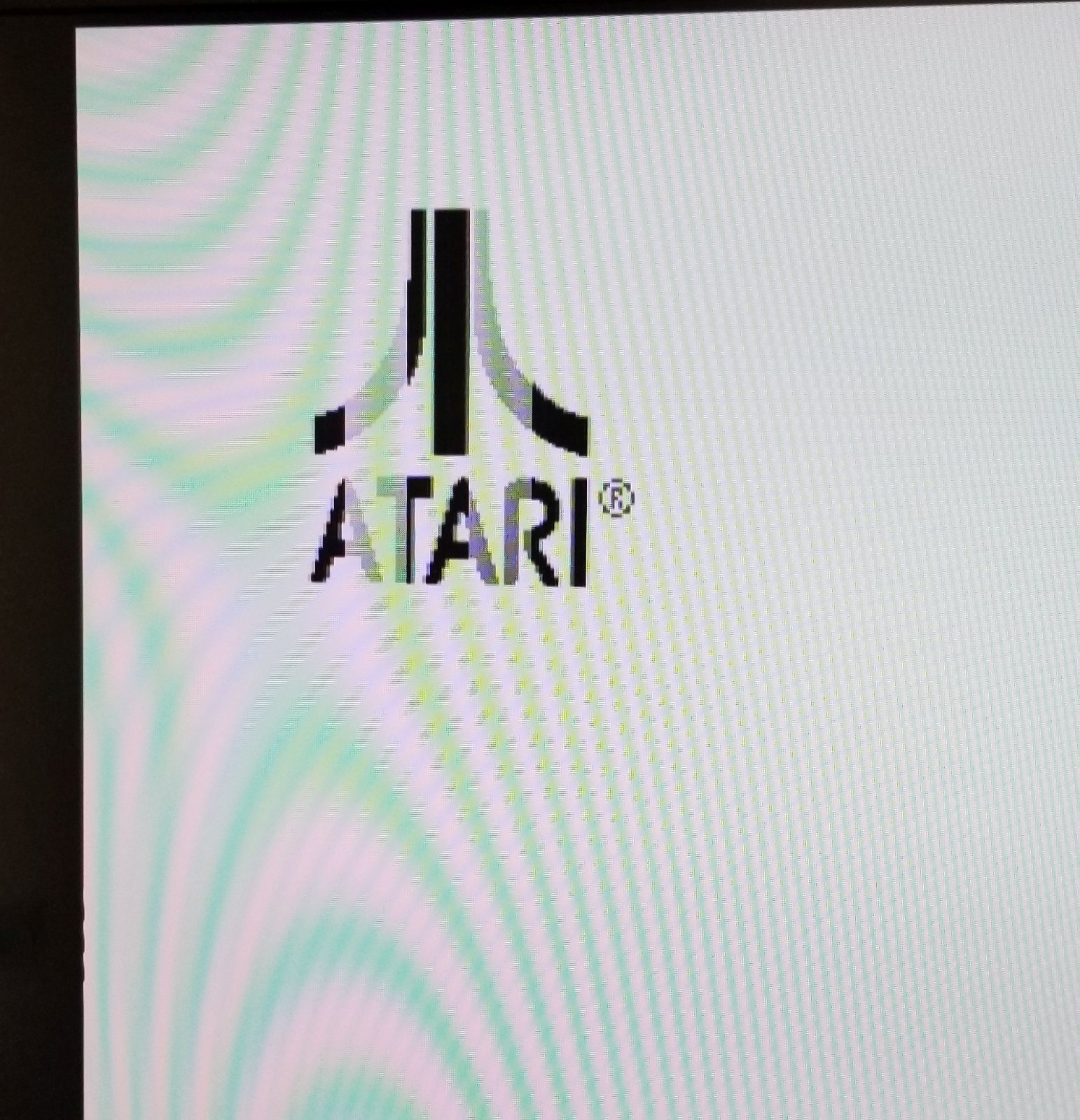

SO re-did the booster - got it added and I think everything wired up.. but I get a boot, not stable - funky screen.. I get Floppy access - but funky logo and then crash when trying to get to desktop. Same if I move the jumper and use the TOS on the board 1.4 - but seems a little better??? hard to say.

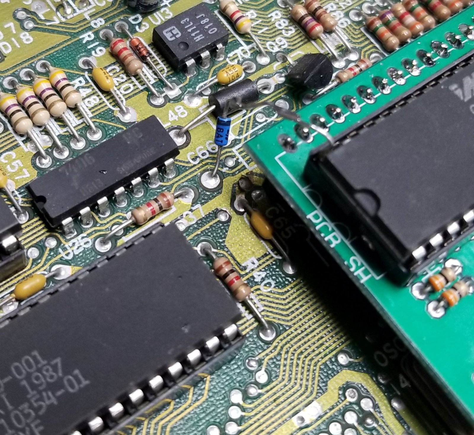

BG pin.jpg (256.99 KiB) Viewed 3302 times
Posts: 29472
Re: 2.2 Booster in MegaST4
Why do you have 2 sets of ROMs running ?
Are you sure you not shorted out the 2 BG pads when soldering ?
The diode on the shifter is a untested mod. I don't know if that would screw up the GAL or not.
Have you tried 8mhz mode ?
Have you changed the bus pullup resistors ?

exxos wrote: Wed Apr 12, 2023 9:42 pm Why do you have 2 sets of ROMs running ? I used the jumper on the booster to switch between 1.04 and 2.06??? -J5 right?
Are you sure you not shorted out the 2 BG pads when soldering ? YES - the upper pad is actually missing.. cant touch it.. not me :)
The diode on the shifter is a untested mod. I don't know if that would screw up the GAL or not. - THAT is factory.. I have seen it before; not often. If I remove that diode.. the machine will not boot; period.
Have you tried 8mhz mode ? - Not sure how to pick modes????
Have you changed the bus pullup resistors ? This board is 4.7k - So Dont think I need to play with those.. I am hoping I dont. If the owner wants me to get that deep into this, that will be up to him.
in the install STFM there is PIN13 of the left GAL to GND - DO I need to do that on the MEGAST?? I dont have that yet.

Pin 13 to 0v forces 8mhz mode.
You have to remove the motherboard ROMs. The jumper selects the bank in the dualtos chip.
As for resistors, read the bottom of the page https://www.exxosforum.co.uk/atari/last ... /index.htm
