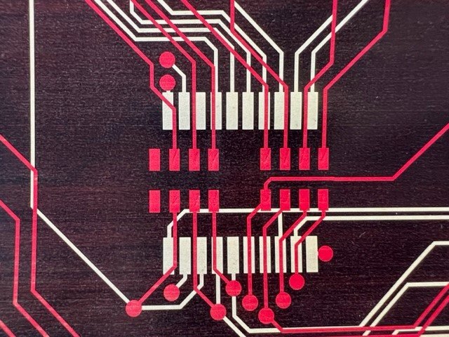

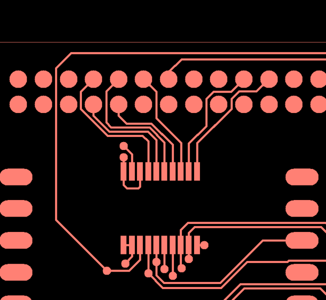

Hsommer wrote: Thu Dec 22, 2022 12:24 pm Yes, I tried several times to check for continuity(and shorts), between the IC footprints and the RN's footprints, everything looks fine...
Also you checked IC6 to the IDE port ?
Yes I did, but it would be more easy, If I had a diagram, but nobody seems to have it???

Also check that Pin 19 is connected to GND and Pin 20 is connected to +5V. Easiest to measure from the PWR2 header below the regulator.

I've no plans to release the schematics. But why not try each IC in turn to see if its any one set of pads?
The thing should work in a mix and match mode.

go0se wrote: Thu Dec 22, 2022 1:50 pm Also check that Pin 19 is connected to GND and Pin 20 is connected to +5V. Easiest to measure from the PWR2 header below the regulator.
Screenshot from 2022-12-22 13-43-36.resized.pngScreenshot from 2022-12-22 13-44-02.resized.pngScreenshot from 2022-12-22 13-44-23.resized.png
I checked IC6; VCC is at pin20 , gnd at pin10, gnd at pin19, dir at pin1(connected to pin1 IC4 + IC5.
My board is revision 2, it does not correspond to the footprint of the first photo, but correspond to the connections at the diagram of IC6...
download/file.php?mode=view&id=29366
download/file.php?mode=view&id=29364
The unused buffer A0 - B0 is connected differently...

Is your board 2 or 2b? Plain rev2 will not work with buffers but i've no idea how you got it if you did. There was only 10-20 of them made.
