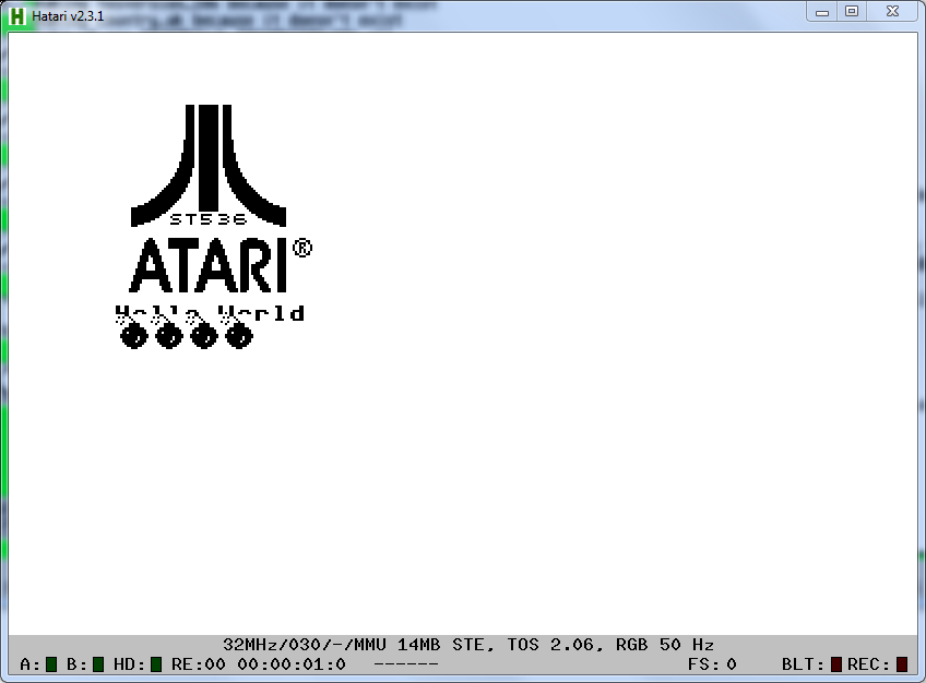

mfro wrote: Thu Dec 08, 2022 3:14 pm Now it depends on where "appropriate" is. You are calling a GEMDOS function now. That's supposed to fail as well until GEMDOS is fully initialised.
Dammit... So how are you supposed to draw text after the logo them because it looks like the code uses the same stuff anyway..
crcmsg: dc.b 'WARNING: BAD ROM CRC IN CHIP ',0
crcmsg2 dc.b '.',13,10,0
crcfail:
        move.l    a5,d5
        pea.l     crcmsg
        move.w    #9,-(a7)
        trap      #1
        move.b    #$45,d0            /* 'E' - even */
        btst      #0,d5
        beq.s     chipE
        move.b    #$4F,d0            /* 'O' - odd */
All I am really doing is trying to output different text.. And my code is directly under that..

Well here is all the code If you want to have a bash at it, it is only from TOS anyway. I was adding my code around line 1745.. I have taken it out for now because I cannot get anything but the single character code to output anything anyway.

at least in your previous code post, it appears you are missing a terminating 0 byte after the string.
And remember: Beethoven wrote his first symphony in C.
Posts: 29558
Re: ASM detect CPU type ?
mfro wrote: Thu Dec 08, 2022 4:11 pm at least in your previous code post, it appears you are missing a terminating 0 byte after the string.
ohhhhhh

Good start. At least the string is there. And TOS is still able to properly throw bombs, so you probably didn't do too much damage ;)
GEMDOS calls trash registers D0,D1 and A0-A2. If the surrounding code requires it, you'll have to save and restore these.

Perhaps the bombs are due to the absence of a boot device. (No floppy drive configured, maybe?) EDIT: Then again, Hatari has a built-in debugger, so it should be easy to find out where and why it bombs.

The bombs are expected because it is running a 68000 CPU on a 030 build of TOS. Hence trying to construct a routine which handles this more elegantly.

So this seems to be causing it to crash even just by itself :shrug:
infoText:  dc.b 'Hello World',0
