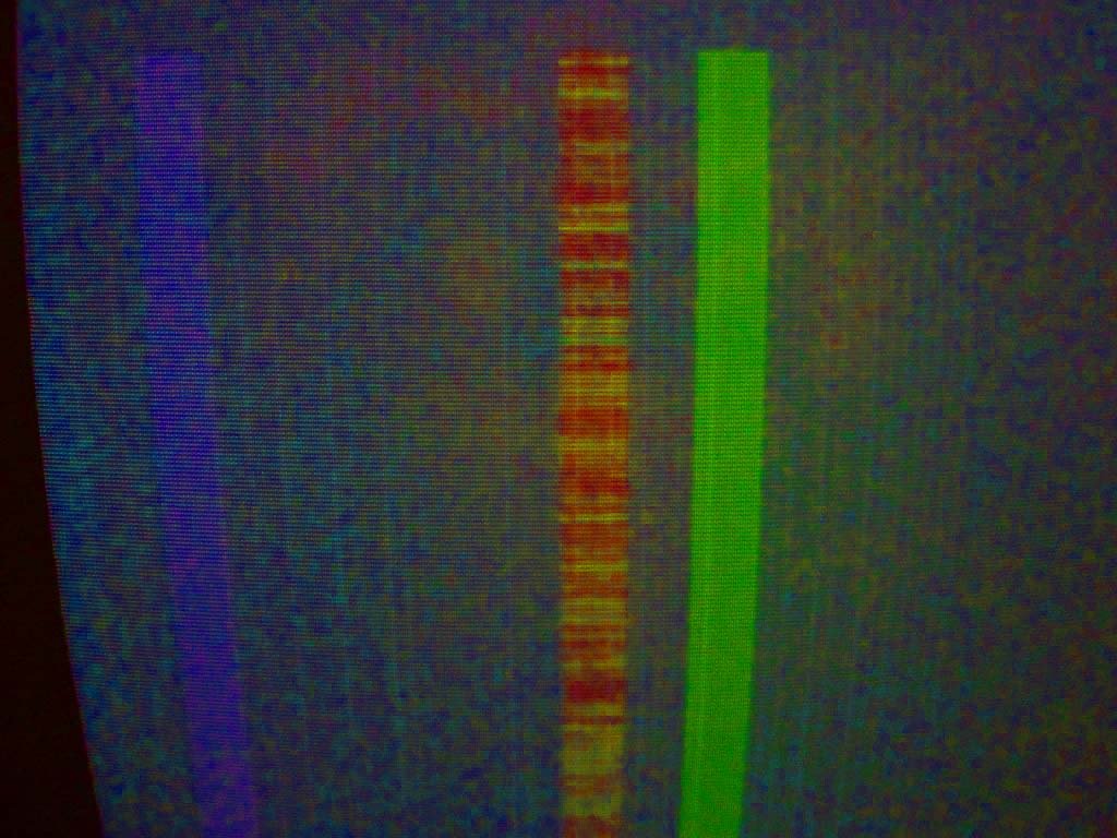

After a bit of thought, Ive found a way of showing some better results with the setup at hand.
If I actually set the top four bits of the palette word (the 4 bits that are not mapped to the STe palette) in various combinations, then perhaps we can see the 16bpp palette colours more clearly.
So here we are:
The STe version, just to confirm, shows no colours in this palette range:
So, despite the top 4 bits being LSB values, (bottom 2 LSBs for G) we can see the colour bars with no image processing of the photos.
Unfortunately, we are only seeing 3 colour bars (along with what I call some chroma noise columns) where there should be 7 :(
The program should be displaying 7 colour bars, with a black bar between each one.
The colours SHOULD be (from left to right):
-------GRGB
4096, 0001 0000 0000 0000 BLUE [Shown]
8192, 0010 0000 0000 0000 GREEN [Missing]
16384,0100 0000 0000 0000 RED [Missing]
32768,1000 0000 0000 0000 GREEN (LSB) [Looks more like red with moving green interference lines]
12288,0011 0000 0000 0000 GREEN/BLUE [More like Green/Yellow?]
28672,0111 0000 0000 0000 RGB (GREY) [Missing]
40960,1010 0000 0000 0000 GREEN/GREEN [Missing]
Any thoughts @sporniket? :/

Here is the photo with chronic saturation to try to pick up any hint of the other colours:

Good experiment @mrbombermillzy :)
The first thought that I have on the result, is that since the blue bar is showing, I would have expected to see the GREY bar. In that respect, it would be interesting to try the missing combinations.
To sum up
  • BLUE, GREEN, RED (resp 0001, 0010, 0100)
  • GREEN(LSB) (1000)
  • GREEN + GREEN(LSB) = STRONG GREEN (1010)
  • BLUE + GREEN = CYAN (0011)
  • BLUE + GREEN + GREEN(LSB) = GREEN LEAF (1011) (not tested yet)
  • BLUE + RED = PURPLE (0101) (not tested yet)
  • BLUE + GREEN(LSB) + RED = MAUVE (1101) (not tested yet)
  • GREEN + RED = YELLOW (0110) (not tested yet)
  • GREEN + GREEN(LSB) + RED = LEMON YELLOW (1110) (not tested yet)
  • BLUE + GREEN(LSB) = SKY BLUE (1001) (not tested yet)
  • GREEN(LSB) + RED = ORANGE(1100) (not tested yet)
  • BLUE + GREEN + RED = GREY (0111)
  • BLUE + GREEN(LSB) + RED = PINK (1101)
  • BLUE + GREEN + GREEN(LSB) + RED = LIGHT GREEN (1111)
About the noise and all, as long as you do not install the jumpers on the R/G/B resistors of the main board, the signal is weakened. And since this test is about the least significant bits, it translate as very weak signal to start with, so I am not surprised that the noise starts to be visible. (reminder : the least significant bit on the extension board goes through a 121K resistors, the second least significant bit goes through a 60K resistors ; then it goes through the 1K resistors on the main board, filtered and amplified, impedance matched and then sent to the monitor )
That and maybe some signal enhancing/filtering on the side of the CRT, and maybe that explains some bar not showing.
So I would wait for the resistors on the main board being bypassed before trying to infer more from those result (by the way, the bypass of the resistors is reversible, once you wish to go back to stock.)
