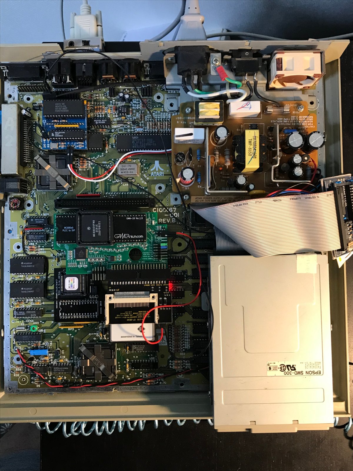

I did not have much time this week to work on my project, but I have managed to go further on a little:
So far, here are the enhancements fitted in my Mega ST:
- 4 MB RAM
- Storm ST (TOS decoder and 8 MB ALT-RAM)
- Exxos Dual TOS PCB (TOS 1.04 / TOS 2.06)
- Exxos 1.44 floppy upgrade PCB
- Epson SMD-300 FDD with original Mega ST bezel
- Tweety board
- Lightning ST (IDE and USB interface)
Everything seems to work flawlessly, but is not yet fully tested.
I will have to build and try the new CPU relocator as soon as I get it from JLCPCB, as the previous one was unstable.

As yesterday was a typhoon day here in Japan and I had received my parts to build Frank Lukas' new CPU relocator, I spent my day soldering and then trying the new hardware...
... to discover that my Mega ST becomes unstable once the relocator fitted (like with the previous one) and no matter in which order all the other expansions were installed in the machine (relocator first then Storm St, Strom ST first then relocator, etc.).
I have bombs, resets and freezes but everything goes back to normal once the relocator unfitted.
I do not know if there is something related here with the original and recapped PSU being too weak or with the relocator itself.
I will have to try with my STPSU to see if something changes and maybe with another relocator I bought some time ago.
Re: Mega ST project
The mega ST is the worst machine to update. All you can do is the mandatory fixes. Beyond that, you're fighting an unstable bus. Debugging will take a lot of time. It's why I don't support mega anymore. STFM is hard enough. It's why I designed the remake boards. If you *really* want it to work, then get a fast logic analyser like @terriblefire has and start to debug the entire bus to see where the issue is.
Edit:
I think I said before the 8mhz clock from the shifter is really bad, it needs a Schmitt buffer on it and some experiments with series resistor value. 47R is a good start.
Edit:
