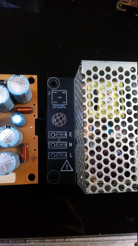

I have a large number of original Amiga PSUs that when used with accelerated Amigas give differing levels of performance and occasionally strange behaviour. I looked into recapping but as some of you know there are several different PSU case shell designs with even more internal PCB layouts so it quickly becomes a chore. Also, by this stage a lot of the PCBs have scorch damage due to failed components and more commonly, broken boards. That tends to be due to weak corners and with the PSU being dropped/kicked about over the years.
I decided to create a base board to mount the RT50B inside the original PSU case. This allows installation without any modification to the original housing (Because hacking up cases to accommodate mods is sacrilege!
) More importantly it carries the supply over to the correct side for the Meanwell, routed on the underside for safety. There are some designs for that already out there but I wasn't happy with them for various reasons.
This design is to fit the shell for the later model 391029 (and others) rather than the DSP-A500 shown in @alenppc original post. The votage output is a nice stable 5V under load.
The RT50-B is also a late revision that according to the data sheet doesn't require any dummy load on the +12 and -12V rails. They could however easily be added if required.
The boards arrived yesterday, so, here are the results. If you don't see any more posts for me then there was a flaw in the design!

Damn that *really* is a nice piece of kit!
Great design!

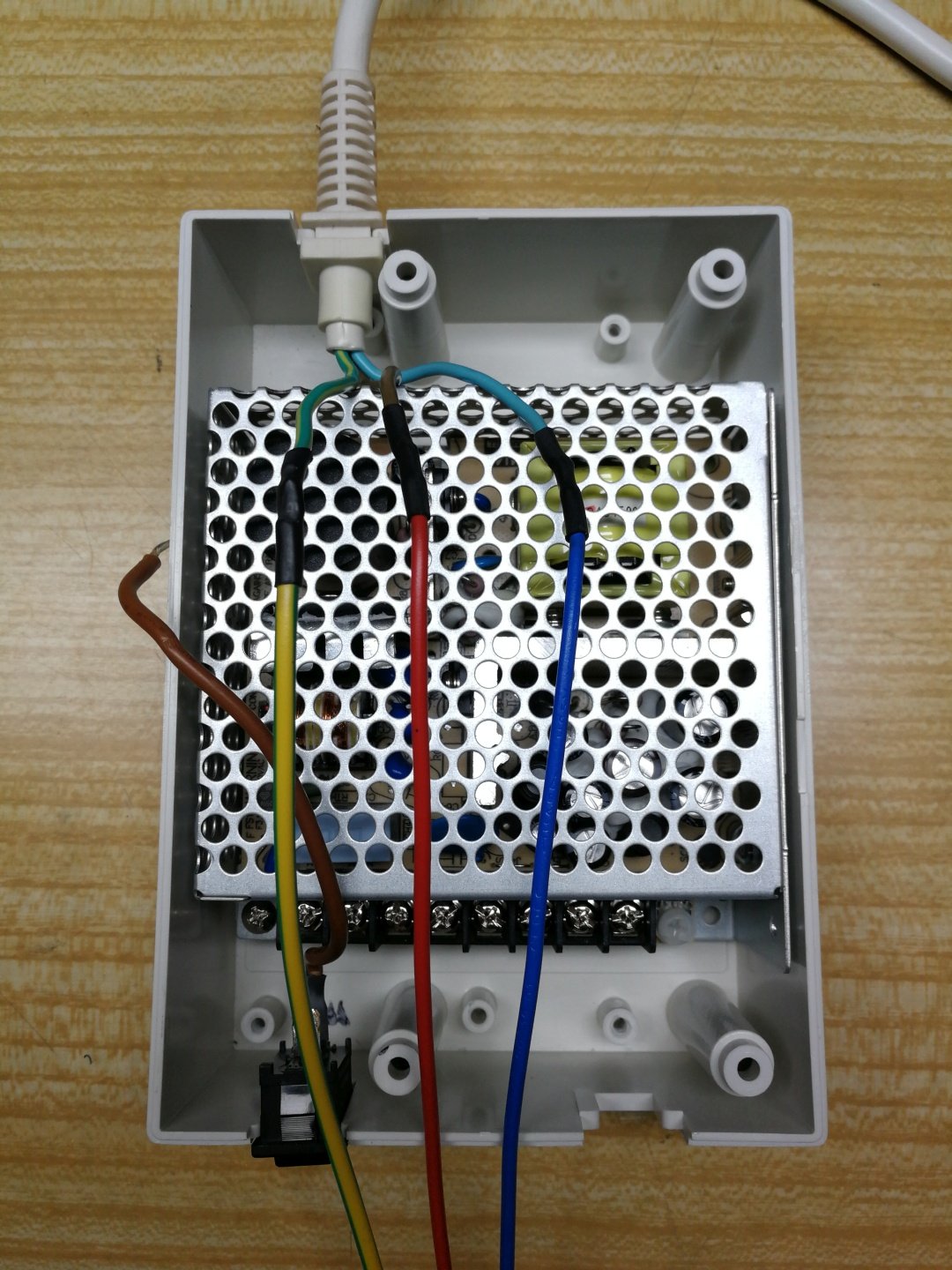

@go0se very nice solution with this bridge/mount PCB!
A recently got an A1200 unfortunately with a defective PSU.
The first thing I did when putting in a MW RT-50B in the PSU case was, to flip over positions of the cables!
Means, the Amiga connection now is on the side with the switch, the power cable on the other side.
So no crossed cables anymore on the desk, as you normally position the PSU with the switch towards you (at least that's how I do it).
This is how I "fixed" the RT-50B in the case (no drilling, easy to put out).
Only three wires instead of five (referring to OP) need to be extended.
The final result.

Wow this is lovely. Did you share the Gerbers for your plate by any chance?go0se wrote: Sat Dec 04, 2021 3:00 pm I have a large number of original Amiga PSUs that when used with accelerated Amigas give differing levels of performance and occasionally strange behaviour. I looked into recapping but as some of you know there are several different PSU case shell designs with even more internal PCB layouts so it quickly becomes a chore. Also, by this stage a lot of the PCBs have scorch damage due to failed components and more commonly, broken boards. That tends to be due to weak corners and with the PSU being dropped/kicked about over the years.
I decided to create a base board to mount the RT50B inside the original PSU case. This allows installation without any modification to the original housing (Because hacking up cases to accommodate mods is sacrilege!) More importantly it carries the supply over to the correct side for the Meanwell, routed on the underside for safety. There are some designs for that already out there but I wasn't happy with them for various reasons.
The boards arrived yesterday, so, here are the results. If you don't see any more posts for me then there was a flaw in the design!![]()
