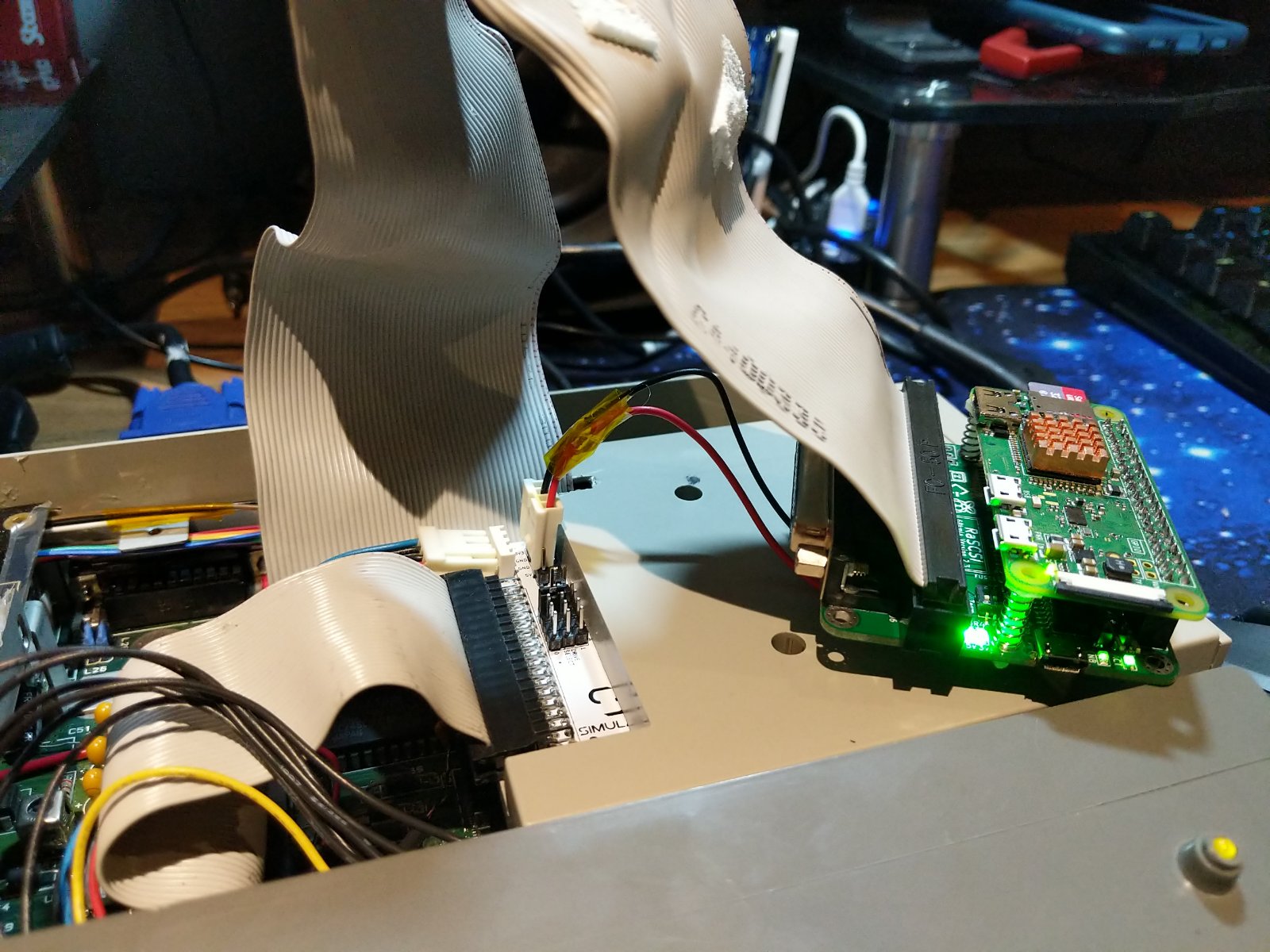

Been playing with the RaSCSI and Falcon today, it's working really nice! It is kind of awesome, the RaSCSI is running Debian and connected to WiFi, so I can SSH into it, DD a fresh drive image, mount the image in the RaSCSI service and voila it shows up on the Falcon :) Very cool!
Looking forward to playing with Daynaport SCSI ethernet emulation, which would effectively make my Falcon wireless :D
Powered the RaSCSI by piggy backing off the Gotek:
