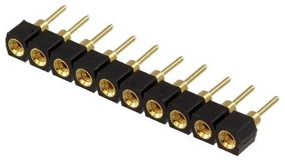

I've just removed the U1 IC socket so I can recheck all connections (they all checked out OK, but you never know -and at least one PCB trace had its hole awfully close to a via which may have been shorted when I inserted the IC socket), including all the motherboard vias in the surrounding area.
Instead of putting a socket back in I'll be using "round socket connectors" (item #0169) (also called "SIP sockets") which I just received from Exxos. They'll take up less space (no longer visually blocking the view as a normal IC socket does), and for attaching those wires from U1 which will go to the MonSTer board -I can solder those directly to the sides of the applicable pins (just remove the black plastic with a hobby-knife, revealing the metal pin).
Unlike an IC socket which you just put in place I need to align all these different socket connector pieces so the IC will fit straight on top. As discussed in this thread I think I'm going to plug all the needed round pin sockets into the bottom of a suitable IC socket, push the whole "assembly" into the U1 location, then solder the pins from the underside of the MSTE motherboard. That should keep it all aligned! Then I can remove the IC socket on top and insert the 74F244.
Now all I need it time and patience
