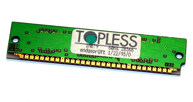

Mine are "Topless" 1MB*9 just like this (60 or 70ns, I can't remember):rubber_jonnie wrote: Sun Jan 24, 2021 3:03 pm I have seen non parity 3 chips SIMMS, there were 2 3 bit and one 2 bit chips on there, which surprised me a little, not that I'm saying this is the rule, more like the exception.

I seem to recall that brand actually, though I don't have any in my Big Bag 'O RAM. I think I see a 60ns printed just above the1/22 section of the date.beel1 wrote: Sun Jan 24, 2021 3:38 pm
I recently fitted a Marpet adapter to a Mega ST and dropped 4MB in, the first lot I found being parity. Didn't work, as soon as I put non parity in it was fine and dandy.

This is a picture I found on the internet, it's not the one inside my Atarirubber_jonnie wrote: Sun Jan 24, 2021 5:17 pm I think I see a 60ns printed just above the1/22 section of the date.

Ahh, I seebeel1 wrote: Sun Jan 24, 2021 5:53 pmThis is a picture I found on the internet, it's not the one inside my Atarirubber_jonnie wrote: Sun Jan 24, 2021 5:17 pm I think I see a 60ns printed just above the1/22 section of the date.![]()
