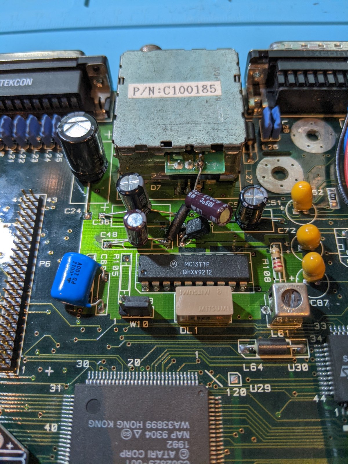

RECAP MODULATOR SECTION
~ BEFORE
~ AFTER Note: the 470uf C24 cap is installed the / CORRECT / way, as it is marked incorrectly on board/schematics
