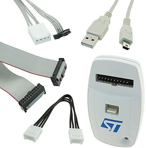

I need some help with the ARM device. Where does the ARM Pin 1 go? Could someone post a closeup pic of the orientation?
I bought the ST Link V2 programmer like this one:
I checked the pinout of the 20-pin connector, and connected the Dupont wires like this:
Pin 1 VAPP to Riser header Pin 1 (VCC)
Pin 4 GND to Riser header Pin 2 (GND)
Pin 19 VDD33 to Riser header Pin 3 (VCC3.3)
Pin 15 NRST to Riser header Pin 4 (NRST)
Pin 9 SWCLK to Riser header Pin 5 (SWCLK)
Pin 7 SWDIO to Riser header Pin 6 (SWDIO)
Is this the correct way to connect them for programming?

I use cheap knock off programmer like this:
https://www.ebay.co.uk/itm/233858024976
You connect
SWCLK
SWDIO
GND
and power it up, so either 5V or you program hooked to cd32.

Ok, thanks. I can't seem to be able to connect to it from the STM32CubeProgrammer. Can you post a close up pic of how did you solder the STM32F722? I want to make sure I didn't place it backwards or something.

Try ST link programmer.

This ST programming software is utter garbage. On the PC it can't communicate with anything, often times it won't even find the programmer and it definitely won't connect to the chip, it's not even able to update the programmer firmware. On the Mac, the tool won't even start.
I am not sure if maybe I need to have 32 bit windows for this? I only have 32-bit WinXP but the tool won't run on that.

STM32 ST-Link Utility?
This one? https://www.st.com/en/development-tools ... nk004.html
I used this under Win 10 without any issues.
You can install STM32CubeIDE, it works ok on Win10 and Linux.
But issue will be programming optimised for speed firmware.

Yeah, nothing works. I tried on an old laptop now, and at least there it will connect to the programmer, but still won't see the chip. Tells me to change the mode, but once I do, it just tells me to change it again.
