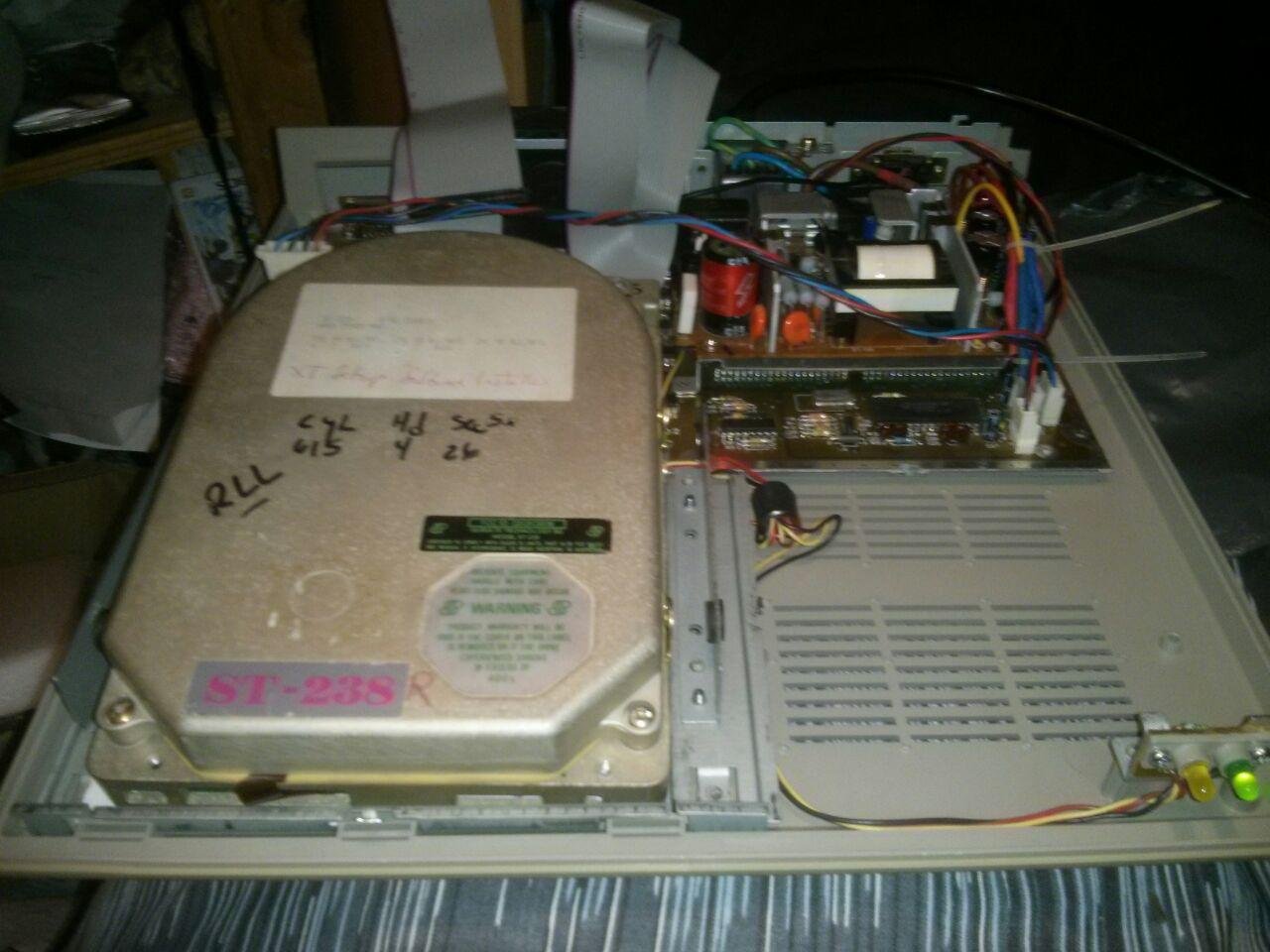

Hi again. After several hours of connecting wires, soldering and stuff, the PSU is complete and it power up the megafile board.
It also powers up and seems to send activity to the ST 238R too.
Unfortunately i have a huge issue. I've nothing to secure the drive with. And i can't power it on properly f it's touching the motherboard.
I have nothing capable of holding the drive at all.
Anyone have suggestions?

Re: Atari Megafile PSU question
Post by atari030 »
A nice big chunk of anti static packing foam under the drive is the old go to that works for bench testing. Or are you after a permanent solution?

The bracket that holds the hard drive on the the megafile case are backwords
@AtariFox
Tom
Post by AtariFox »
atari030 wrote: 22 Jul 2020 05:14 A nice big chunk of anti static packing foam under the drive is the old go to that works for bench testing. Or are you after a permanent solution?
Permenant. Since it wont always be out of the cupboard.
Post by AtariFox »
Tomswork wrote: 22 Jul 2020 05:27 The bracket that holds the hard drive on the the megafile case are backwords
@AtariFox
Tom
Oh they are? I'll try later to see if i can get it right. They didnt seem to want to line up any other way.
