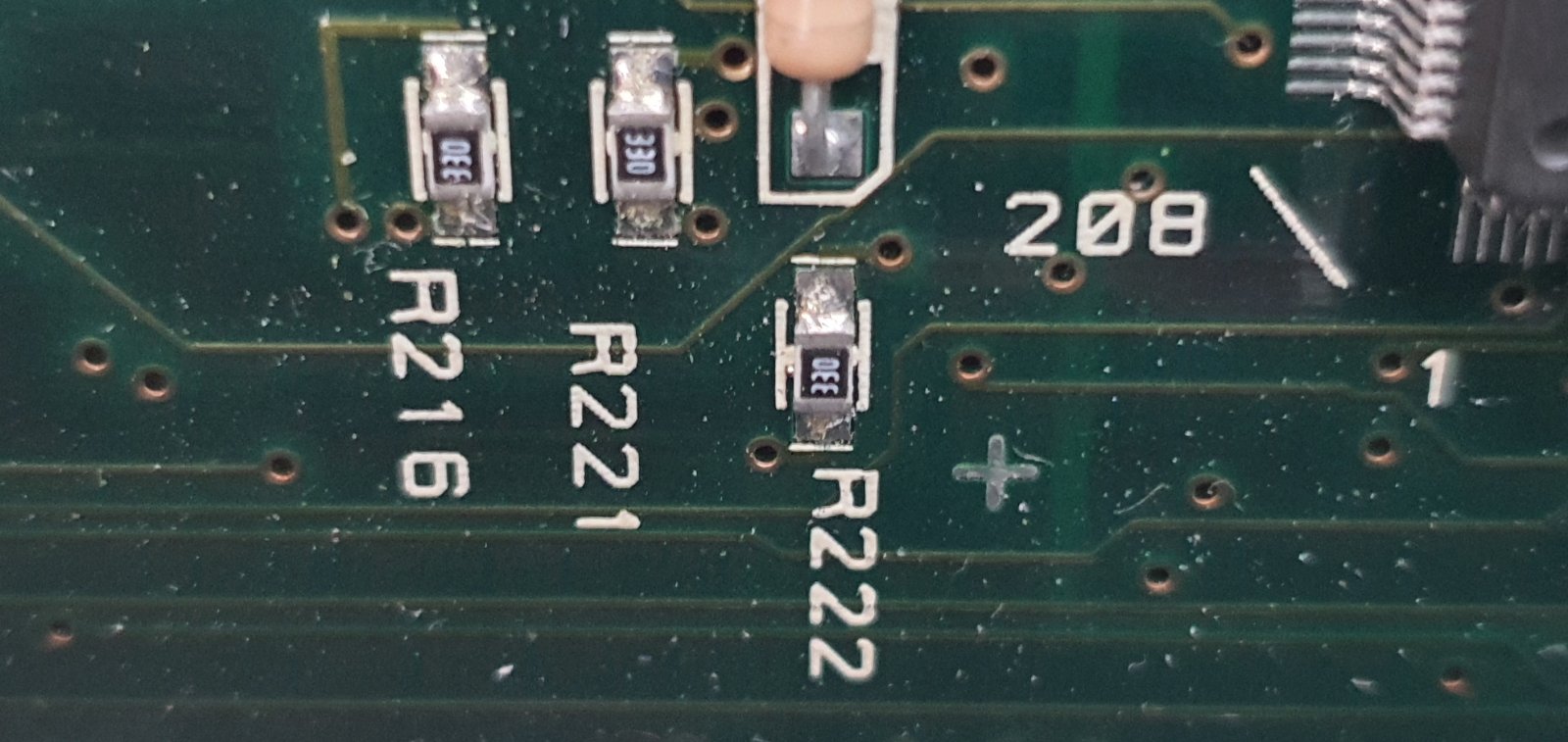

When it comes to the symptoms, sure, changing the NVRAM IC (Dallas) & PSU is the first thing to try, especially if you didn't do anything "stupid". However having a screen like that can be caused by other issues, too - for instance if there is an issue with the clockpatch resistors (R216, R221, R222) - cut, shorted, damaged, ... all sorts of strange things can happen.

I changed the power supply by one that has been recapped (not by myself but by a skill person; I will recap mine later, maybe this afternoon) : the screen is unchanged and presents the same strange green stripes.
I followed your advice Mikro and I checked the 3 resistors R216, R221 and R222: they are very clean (see enclosed picture) and all three have the same value of 33 ohms, which seems to be the right value.
As these first two checks did not identify the root cause of the problem, I will change as proposed, the Dallas chip (even if I am skeptical about the fact that this solves the problem) and will keep you aware about the result.
