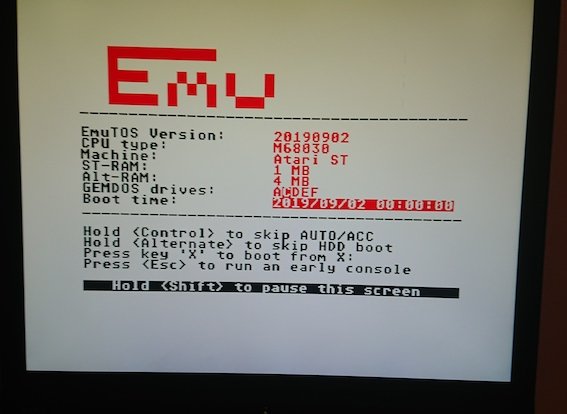

Re: Agranlunds TF534 Build
Haha I just spent way too much time troubleshooting why accessing the onboard RAM only gave me bus errors, including re-soldering the ram and cplds... and now I feel like a complete idiot
The firmware I am using was apparently mapping the onboard RAM to 0x40000000, not 0x00400000 like the MonSTer as I assumed. So basically... never assume
As I was about to remap the onboard RAM to 0x00400000, it got me thinking though.
Isn't it instead better if the TF cards, with Atari specific firmware, maps the onboard ram as TT RAM instead of "alt-ram"?
After all, that's how Atari introduced FastRam, and it would also mean that we could, just the TT, support much more RAM.
(I guess it's not relevant for the TF534, but very interesting for the TF536)
TT RAM lives in the 32bit memory space and starts at 0x01000000:
$01000000-$013FFFFF|TT Fast Ram
$01400000-$FDFFFFFF|Reserved
(Since TT's can have 128MB RAM expansions, I assume that ram just keeps going into the Reserved space? Or does anyone know for sure? I never had a TT)
Another big benefit would be that EmuTOS should be able to auto-detect and install it, and perhaps even Atari TOS (unless it's depending on some other registers before starting TT RAM detection, or if perhaps only TOS 3.0 and higher does it?)
Nevertheless, if the OS cannot auto-detect it we would be no worse off anyway, and would have to install it in a similar fashion to how the MonSTer application does it.
The only drawback I can think of is perhaps compatibility with a theoretical badly written application, that assumes 24bit addressing and leaves garbage in the upper 8 bits - but that would have been a problem on a TT as well - and I suppose Atari already tried to solve this issue with PRG fastram load/alloc flags.
I'm just thinking out load really. I will remap the RAM as TT ram on my card and give it a go.
But if that works well then that would be my suggestion for the official firmware.
Yeah ok, I'm now convinced that the onboard ram should be mapped to TT-Ram space
It basically makes it just work out of the box with EmuTOS.
Atari TOS 2.06 does not detect TT RAM, probably need Tos 3.01 or newer for that, so I'm going to write a simple "driver" to enable it under 2.06 also.
Nice speed boost when running the application from FastRam.
I used the TT application FLAGSETTT.PRG to flag Gembench to both load into and allocate from FastRAM.
EmuTOS itself is not running from FastRAM here, but it can be compiled to be RAM-Loadable from any location so that's on the todo list.
TT version of Yaart just works of course.
