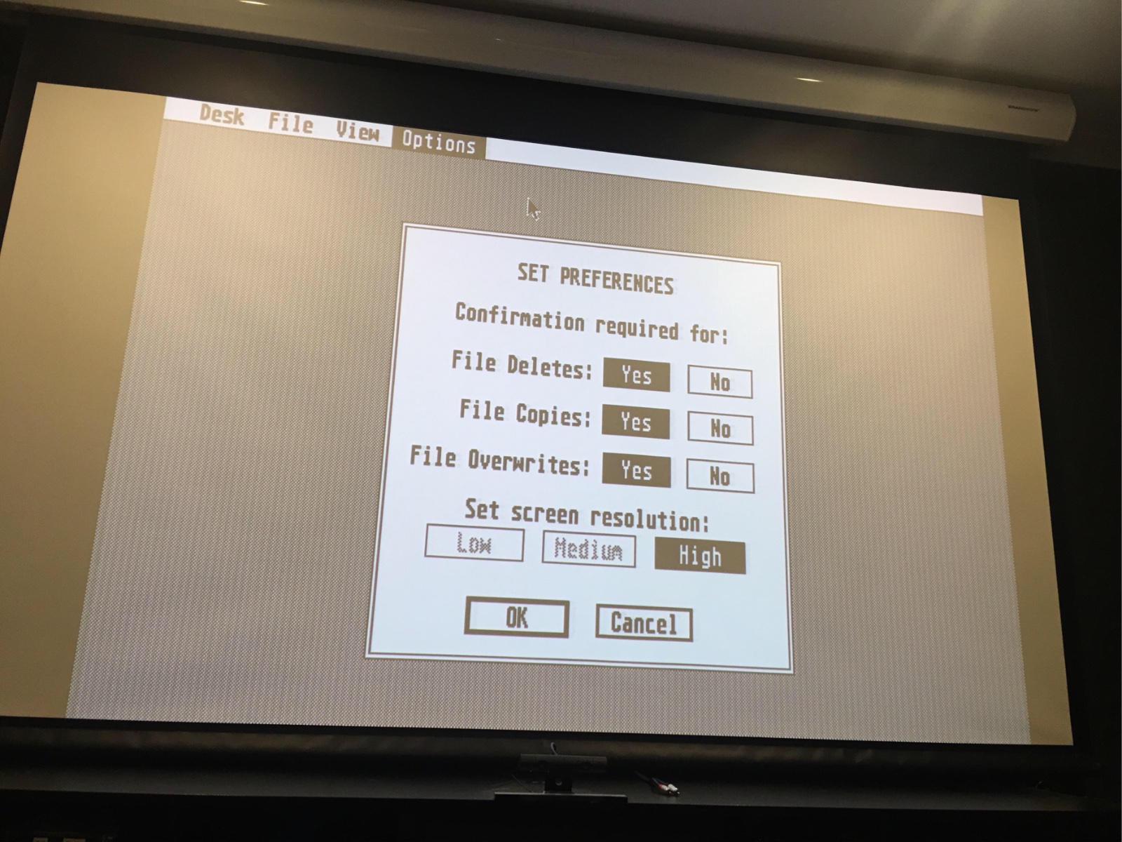

I have worked out it is not the monitor but the Atari itself causing this weird issue. I have acquired a ST2VGA and on an older LCD monitor and my OSSC it still does the same thing. One thing I have discovered though that in High Res Monochrome the Atari screen is fine and tested on Atari High res monitor, my LCD and OSSC. It’s only in Color where the issue is. Here are new images through my projector using the ossc showing high res and colour and the same issue I’ve had all along with the green screen pushing right to he right of the screen and not being able to move it with any vertical adjustments... Any Ideas where to go from here?

Doing a bit more research could this be a problem with the shifter? I’m running out of options. ☹️
