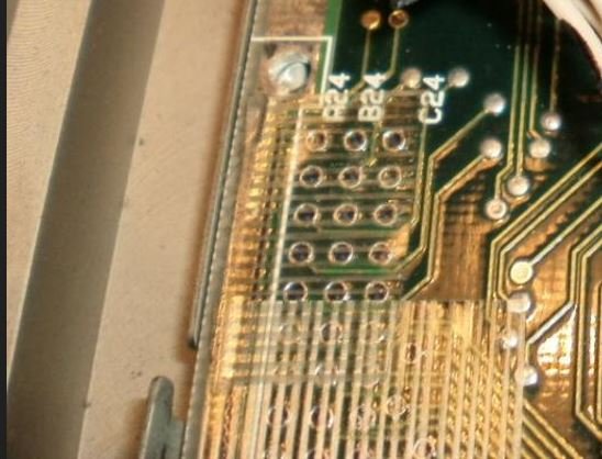

This has got me wondering...although it would probably be 'nigh impossible',
because of the usual space constraints but...
The STacy does have an unused megabus connection on it's motherboard.
Some very early models actually had the port to the outside but that was
dropped and most just have the place for it on the motherboard, without
even a header.
PS I've been waiting for some adventurous (crazy?!) soul to look at putting
the Mega ST version of the ATW800/2 transputer board in one... :lol:
even a header.

Re: Megabus to 68000 socket adaptor

So Frank, I gotta ask - do you honestly think that it's "do-able"?frank.lukas wrote: 17 Aug 2025 18:12 The Atari Stacy has a full MegaST Bus. You need a Male 72pin A-B-C Connector DIN 41617 and a 64pin Male Connector A-B DIN41617 and a Female 72pin A-B-C Connector DIN 41617 on the Atari Stacy Mainboard ...
I was half-kidding when I made that post because of the tight
spaces in the STacy. :)
You can do that and use an ATW800/2 externally. So, just solder the female header into the Stacy and solder a piece of external cable together, connecting the male header to the Stacy and the male header of the MegaST bus connector. The whole thing shouldn't be too long and should work. Otherwise, you could install a PuPla/2 in between to buffer the signals. I've had good experiences with a long Mega ST bus connection.
Female and Male 72pin A-B-C Connector DIN 41617 can be hard to find. In Germany by Reichelt there are only 64Pin ones and more but not 72Pin ones ...
