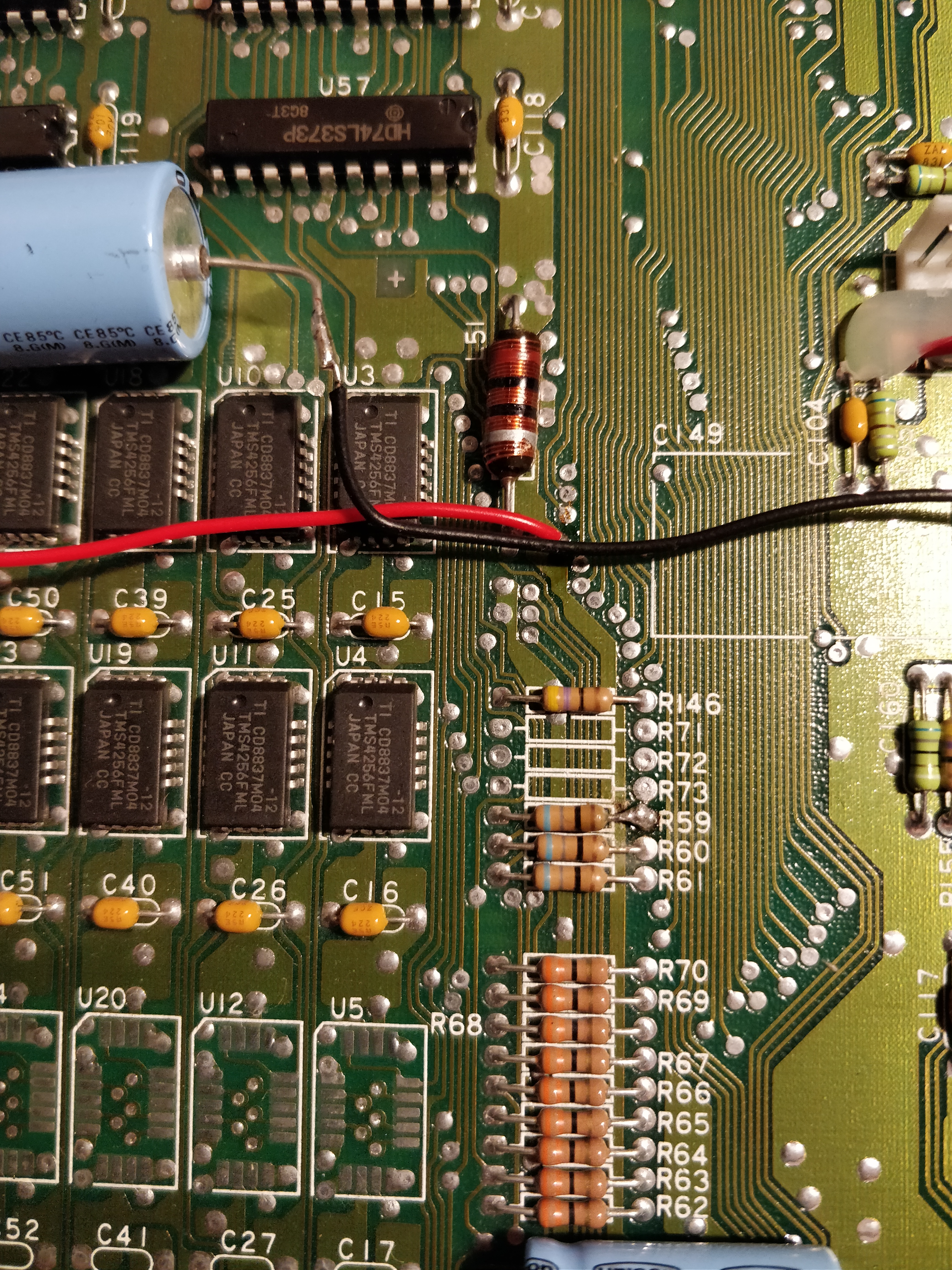

To answer some of your questions, if the MMU pins are clean, and the dot on the MMU matches with the dot on the socket, you should use a magnifying glass to check the contacts in the MMU socket are actually touching the pins on the chip. You can adjust them a little to make sure they do, but best to do it with the chip removed. It doesn't take much pressure to adjust them, so take it carefully.
Here's a pic of my board with the RAM upgrade removed and working, this is how my resistors are, though I couldn't say what voltage you should see:
As I recall R59 was snipped and fed 5v to disable the first bank of RAM i.e. the onboard 512k.
Difficult to say just how good/bad your PSU is. I had a number of working PSUs that would power on a machine, but give all sorts of random errors, particularly on a machine with 'extras' such a an ATonce PC emulator and a PAK 68/2 accelerator board.
As soon as I dropped in a known good PSU, all was well again.
If I'm honest, what you're seeing is the same as I did for the same board, and it was entirely MMU related, in that the contacts were poor.
