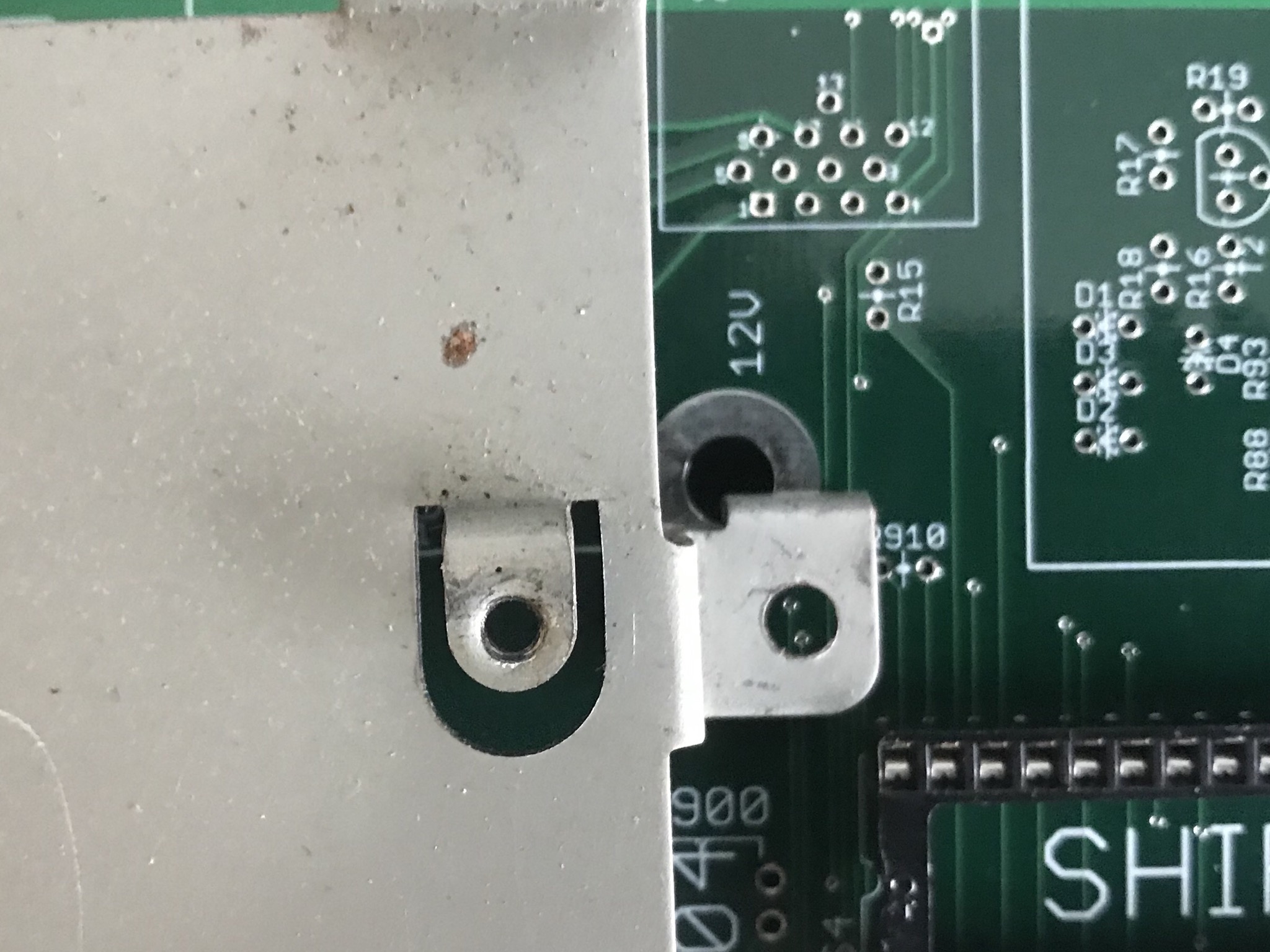

rubber_jonnie wrote: Mon Sep 03, 2018 10:36 pm One last thing I noticed, the reset switch pins are fine, but the metal can has no holes for its tabs. No biggie again, just something to consider for the next iteration.
Yeah, no template for the switch :(, had to use just 3 holes for it. Probably be a lot of things like that, its the case of, if I did everything perfect first time, it would be another year before the board would get made... I think the thing was sat idle for like a year already :roll:

exxos wrote: Mon Sep 03, 2018 10:50 pm
I figured that would be the case, I know this board won't be perfect, hopefully by bringing this stuff up, we can get the next revision sorted out for this sort of thing. I presume it needs an Eagle template or something similar?

Australian boards have arrived safely.
Just checked the PSU plate alignment and the 4 mounting holes are a bit off. 2 at the front line up but 2 at the back will need som attention in a future version. Again not a show stopper.
