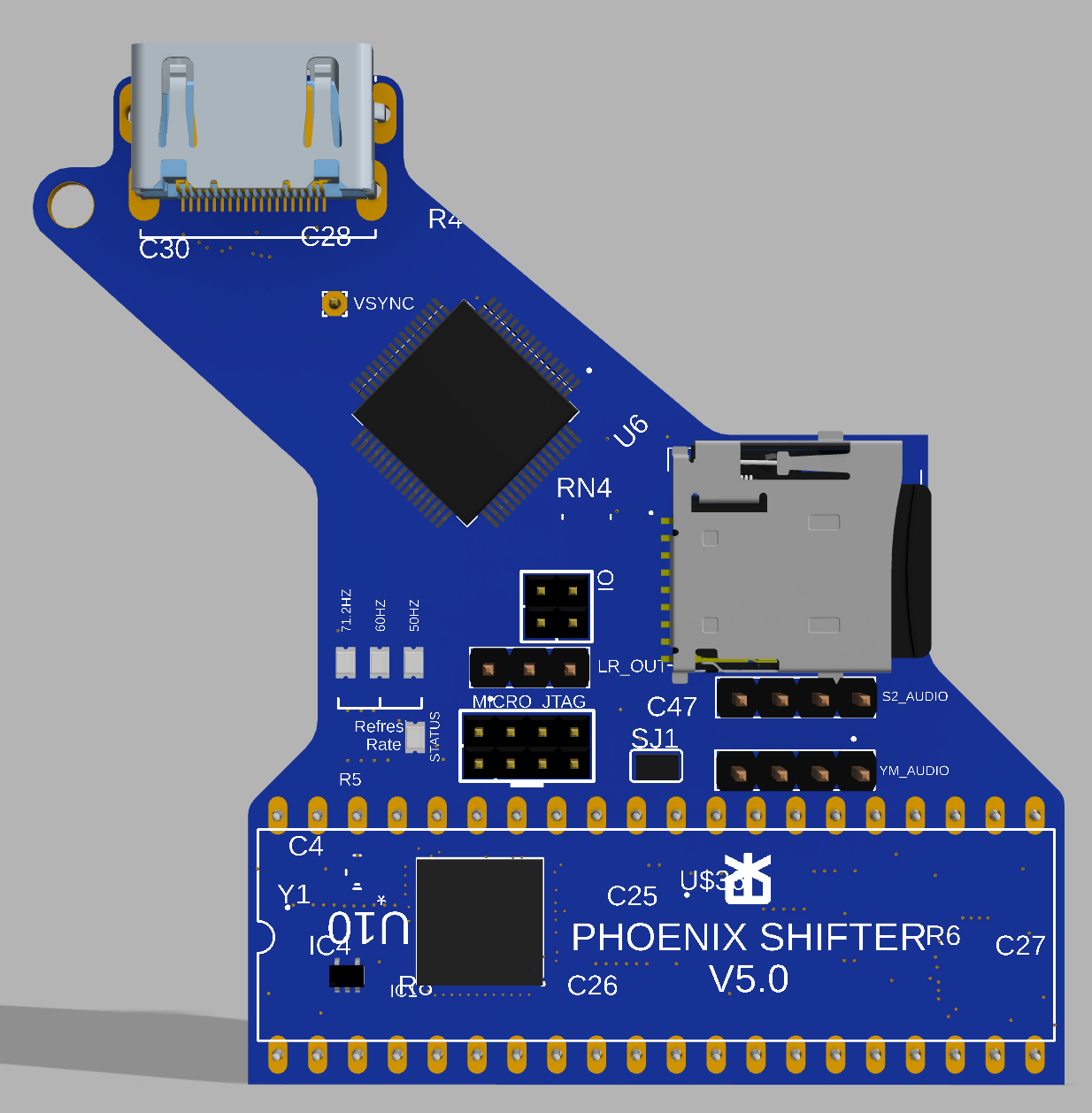

Mock render of v5.0 MAX10 version of the Phoenix Shifter of the H4/5.

Icky wrote: 25 Oct 2026 16:41 However having some beta testers to hone the firmware and features is a path I am taking to help grow this project.
Wise approach and beautiful board. Remember to connect the analog outputs if you have enough pins, as we discussed some time ago.
Btw, Altera now has an "official" mini JTAG connector directly supported by the (super expensive) USB Blaster III. Not sure if it's small enough, but might be worth to check it. Even when the USB III is extremely expensive, using an officially supported connector might still be a good idea.
