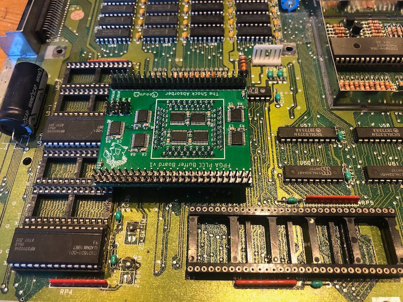

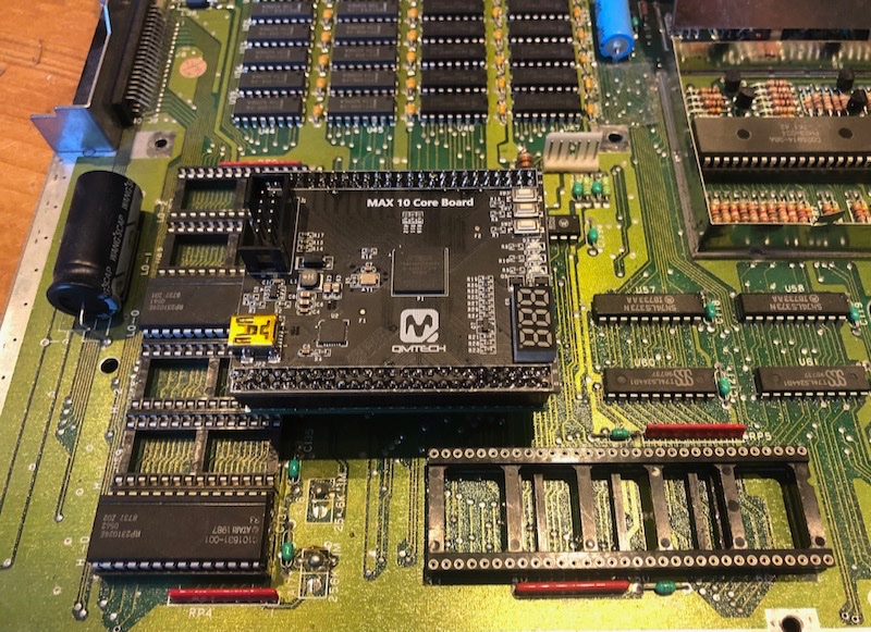

We have been talking about the FPGA MMU for some time in the Blitter recreation thread - https://www.exxosforum.co.uk/forum/viewt ... 329#p29326 and I have finally found some time to sort out the boards we have, so thought I would start a thread just for the MMU development.

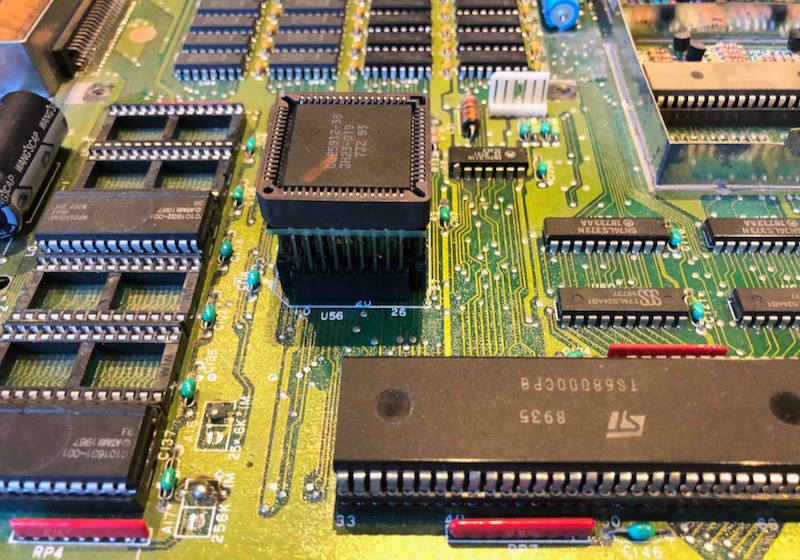

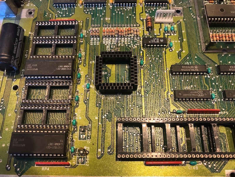

Replacing the funky socket with header sockets enables the ability to plug in one of @exxos funky to PLCC adaptors to make sure the original MMU still works.
This also allows the Shock Absorber 5V <-> 3.3V funky socket buffer board to be put in place then an FPGA dev board on top.
Now the DEV STFM board is ready for MMU testing once we get the firmware sorted.

We have two of these FPGA buffer / dev kit board combos. I have one and @exxos the other.
I have managed to eventually get the board to boot running as an MMU and I can run things like GB6. @exxos however, his board wouldn't play ball and has sent back to me to test and it looks like something is not right with the buffer board so will replace and send back. It did however create some pretty crash screens :)

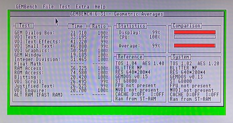

Now this is in no way a solid solution as we have noticed various things that will need to be fixed to make this work properly. Below is a screenshot of GB6 I ran. Its not an exact comparison as the on board ROMs on my DEV ST MB are 102.
The next test after GB6 was the Closure demo and this is where the MMU is tripping up as the demo crashes. Our goal is to get to a point with the firmware where the Closure demo runs, so our FPGA MMU saga continues :)
