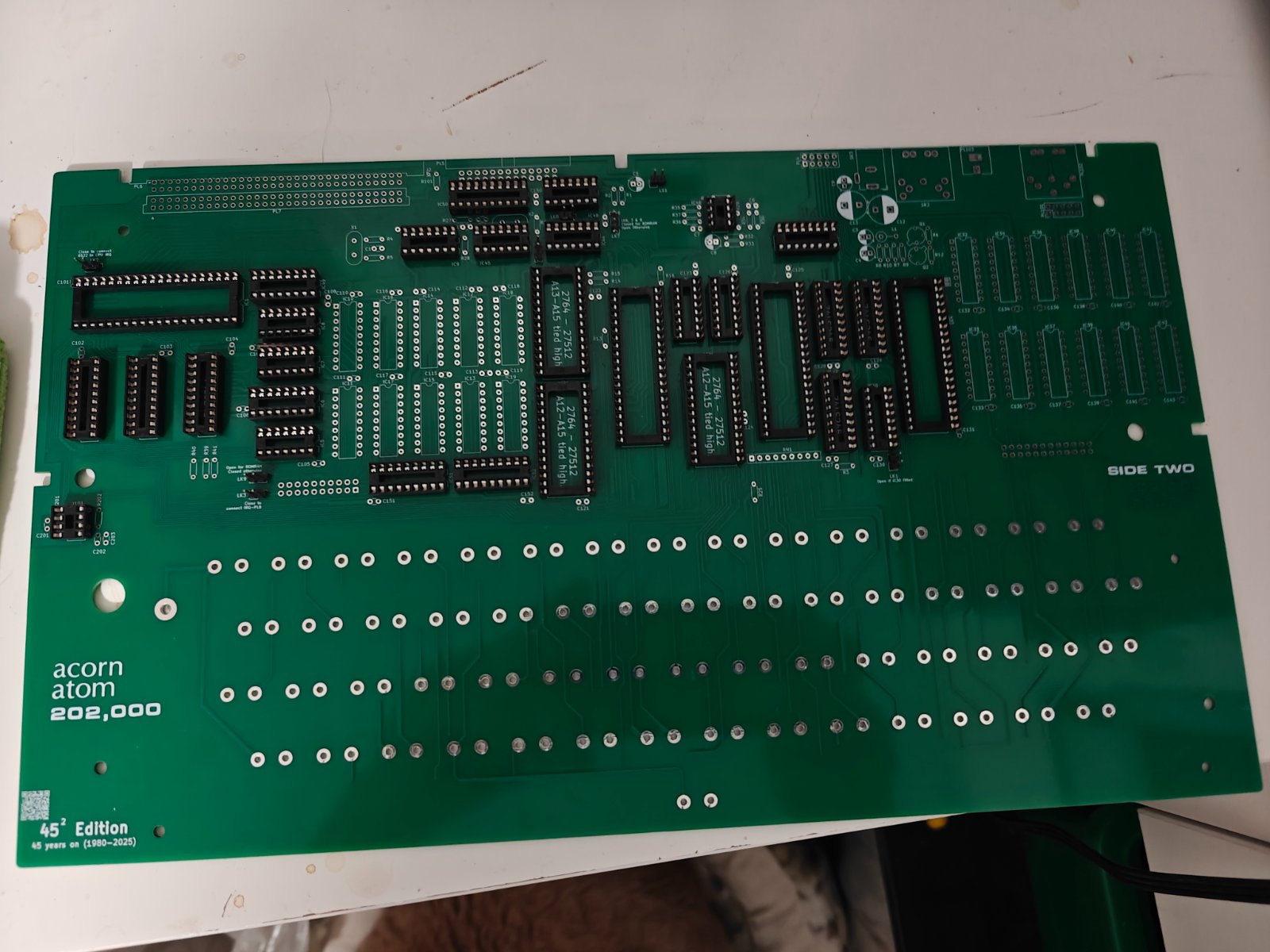

A little progress with the obvious and quick to add parts today. Before:
And After:
Not a huge amount I know, but it's a start and I now have the BoM so I'm ready to start getting all the parts together. I should have quite a few already. I'll get the passives done next whilst I wait for the RAM sockets to arrive.

So some more progress yesterday, I finished installing the remaining sockets which arrived yesterday afternoon:
I usually prefer to do the passives first, but since the board arrived partially built with quite a few sockets already installed, I decided to just go with the flow.

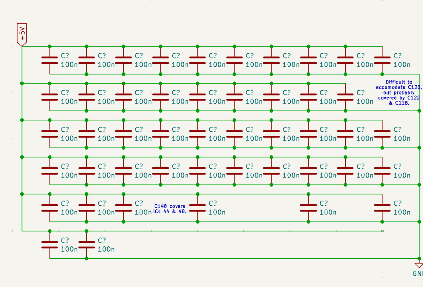

Now they're all done I'm going to do the 47 decoupling caps next, but the BoM didn't show the values:
So a little more digging was required. I had made an assumption that 100nF/.1uF would be about right, but had no evidence and the Atom schematic I have doesn't really match the repro board at all. So I dove into the schematics on the project github page and found the power section, and sure enough 100nF was whats needed:

- Posts: 7512
Re: Acorn Atom Replical build
You can tell from their locations that they're just decoupling caps.

- Posts: 15202
Yeah definitely, it was just the value that was unclear.stephen_usher wrote: Sun Feb 15, 2026 9:09 am You can tell from their locations that they're just decoupling caps.
Nice project.
Reading the github project notes what's interesting is that the decoupling caps were added specifically and it looks like the original machine didn't have a lot of them and the Atom schematic seems to back that up.

- Posts: 7512
Decoupling caps are always the same value for 5V chips. It's just physics.rubber_jonnie wrote: Sun Feb 15, 2026 9:32 am Yeah definitely, it was just the value that was unclear.
With respect to the original design not having many. I've seen a lot of old PCBs which didn't have them at all. Obviously people in the past were not as fussy, and maybe 1970s chips were not as sensitive.
- Posts: 15202
I didn't want to assume, though I had already to decided to us 100nF/.1uF if I couldn't find the actual values, but good to know thatstephen_usher wrote: Sun Feb 15, 2026 12:56 pm
Decoupling caps are always the same value for 5V chips. It's just physics.![]()
Indeed.stephen_usher wrote: Sun Feb 15, 2026 12:56 pm With respect to the original design not having many. I've seen a lot of old PCBs which didn't have them at all. Obviously people in the past were not as fussy, and maybe 1970s chips were not as sensitive.
