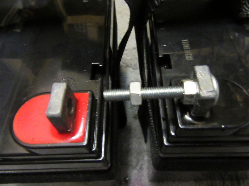

After trying to calibrate it with the software, the battery just drops to zero according to the PSU & software and it won't run from battery. So I put some new batteries on just.. still not convinced the old ones are at fault as only 2.5 years old, which isn't really that old.
Just fitting the fuse...
Will let them charge up and do a re-test.. but I think this "new" PSU is faulty :roll:
Posts: 29386
Found that to do a "manual calibration" you load the PSU and unplug the wall power...
So connected my heater (about 800w per back IIRC ) which is about 30% load and let it run... its beeping like mad.. the battery voltage according to my meter isn't going down very fast either.. so I hope this isn't going to be beeping for the next 2 hours :roll: :lol:
Finally cut out at 19.2V :) So it ran for about a hour and half.. now to charge it all up again...
Interestingly,The power supply is turned off and now connected backup to the mains, so obviously the battery is now charging, and the fan is still running.. So it seems the fan runs when the battery is charging from a discharged state, which I think is a nice feature :)
