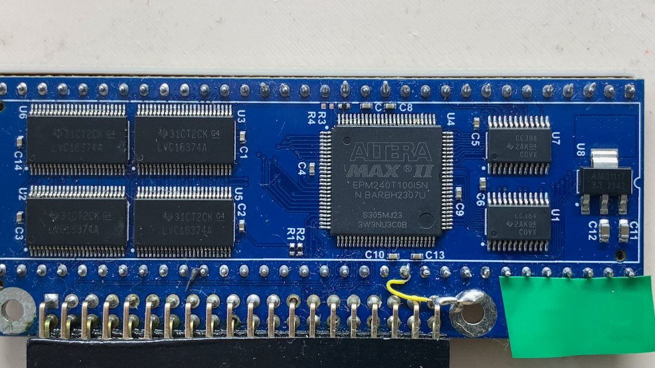

Interesting...so any hints on how can we tell if our adapters will be ok?stephen_usher wrote: Fri Oct 16, 2026 3:20 pm Just popped over to see @dad664npc, who, as it turns out, lives less than a mile away!
He verified that the PiStorm board I have is the problem. Although it works perfectly with an Amiga A500 in a LazaruStorm adapter it's just too slow for the ST.
P.S. Testing with my Pi4 and everything works fine.

Ok, will try to test the couple I have working in A500s in an H4 with my Pi4 as soon as I can.

No idea.JezC wrote: Fri Oct 16, 2026 4:56 pmInteresting...so any hints on how can we tell if our adapters will be ok?stephen_usher wrote: Fri Oct 16, 2026 3:20 pm Just popped over to see @dad664npc, who, as it turns out, lives less than a mile away!
This is the one which doesn't work:
