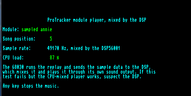

DSP mixing, double the sample rate now :)
I'm running out of room in the Falcon ROM now :lol:
The buffer underrun on the CPU is a speed limitation of ROM access... if only it ran faster...
