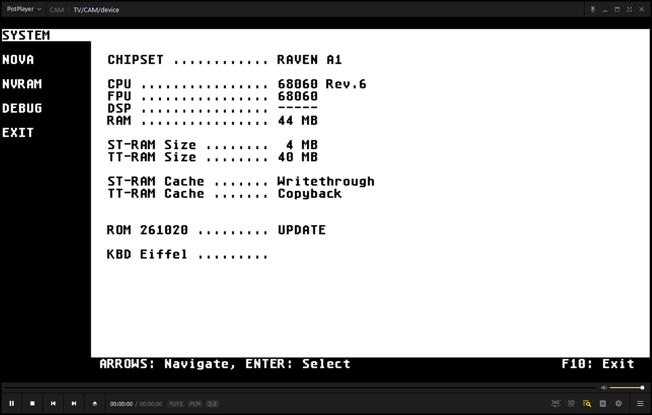

@agranlund Hi, I don't know if you ever got to look into this. I didn't want to bother you with your A2. Now that I'm running the latest drivers, I can still see this issue present. Have you or anyone else seen this? I know I can fix it for me by rolling back the drivers...
Also, I can't seem to be able to flash my CKBD. Should there me an update option here?

Atarian Computing wrote: Sun Oct 25, 2026 10:37 am @agranlund Hi, I don't know if you ever got to look into this.
Nope I completely missed that post. And I think you're right, likely something with those performance improvement changes.
I'll see if I can reproduce it here too.
That looks like it's not being identified correctly and it thinks that it's the standard Eiffel PIC.
I did some changes specifically for A2 and CKBD so that feels like I must have overlooked something and messed something up for Rev.A1.
