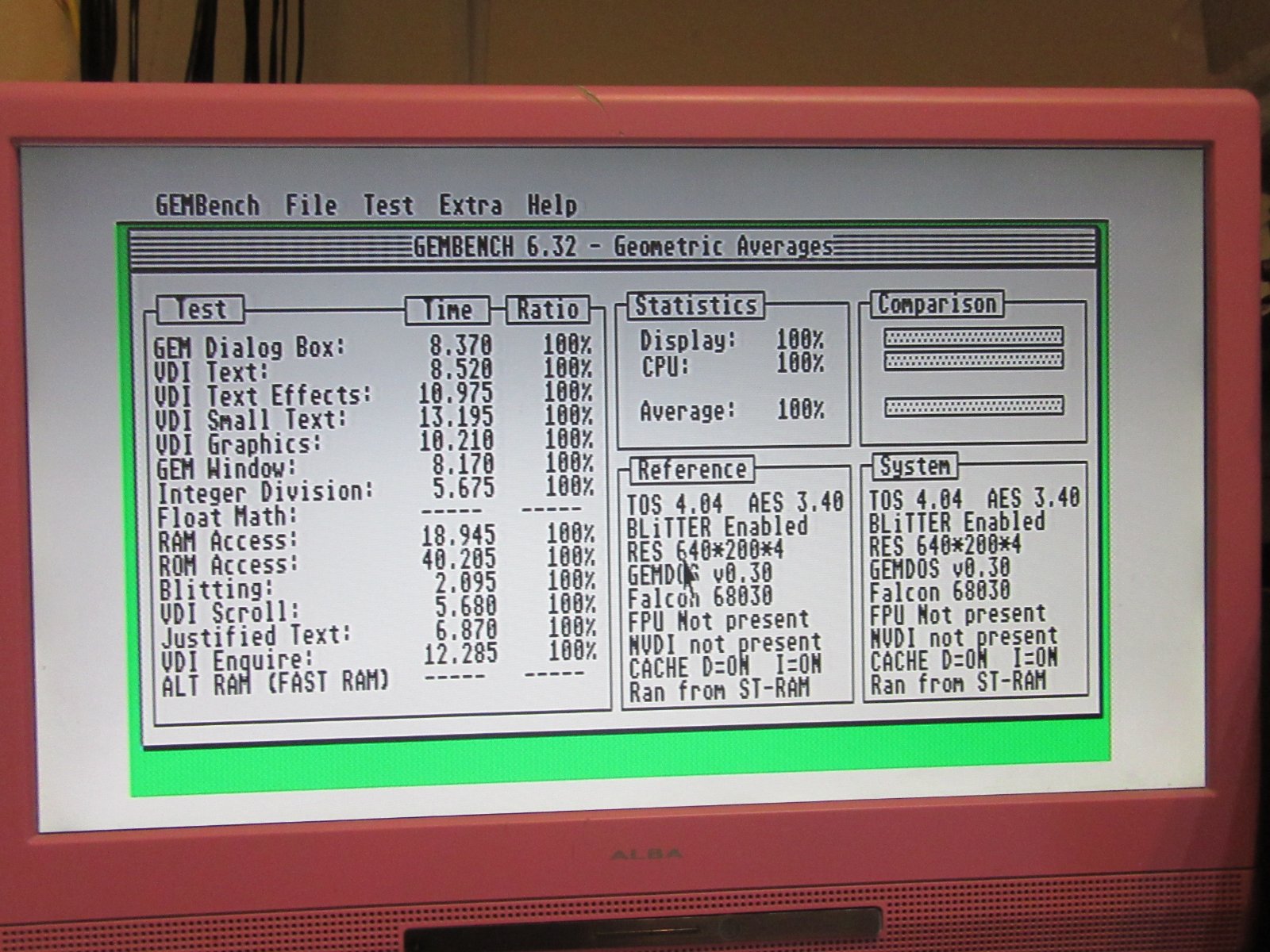

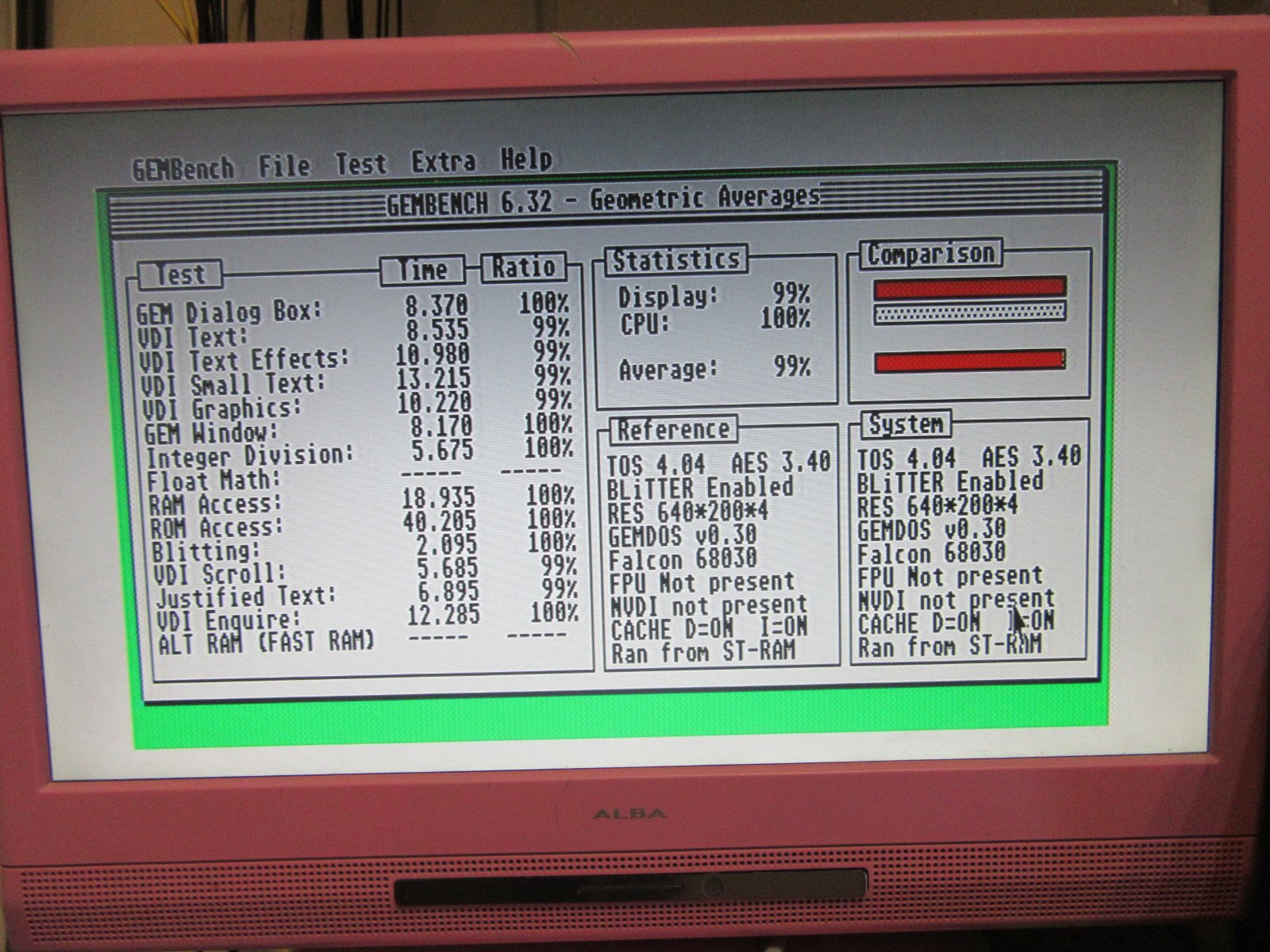

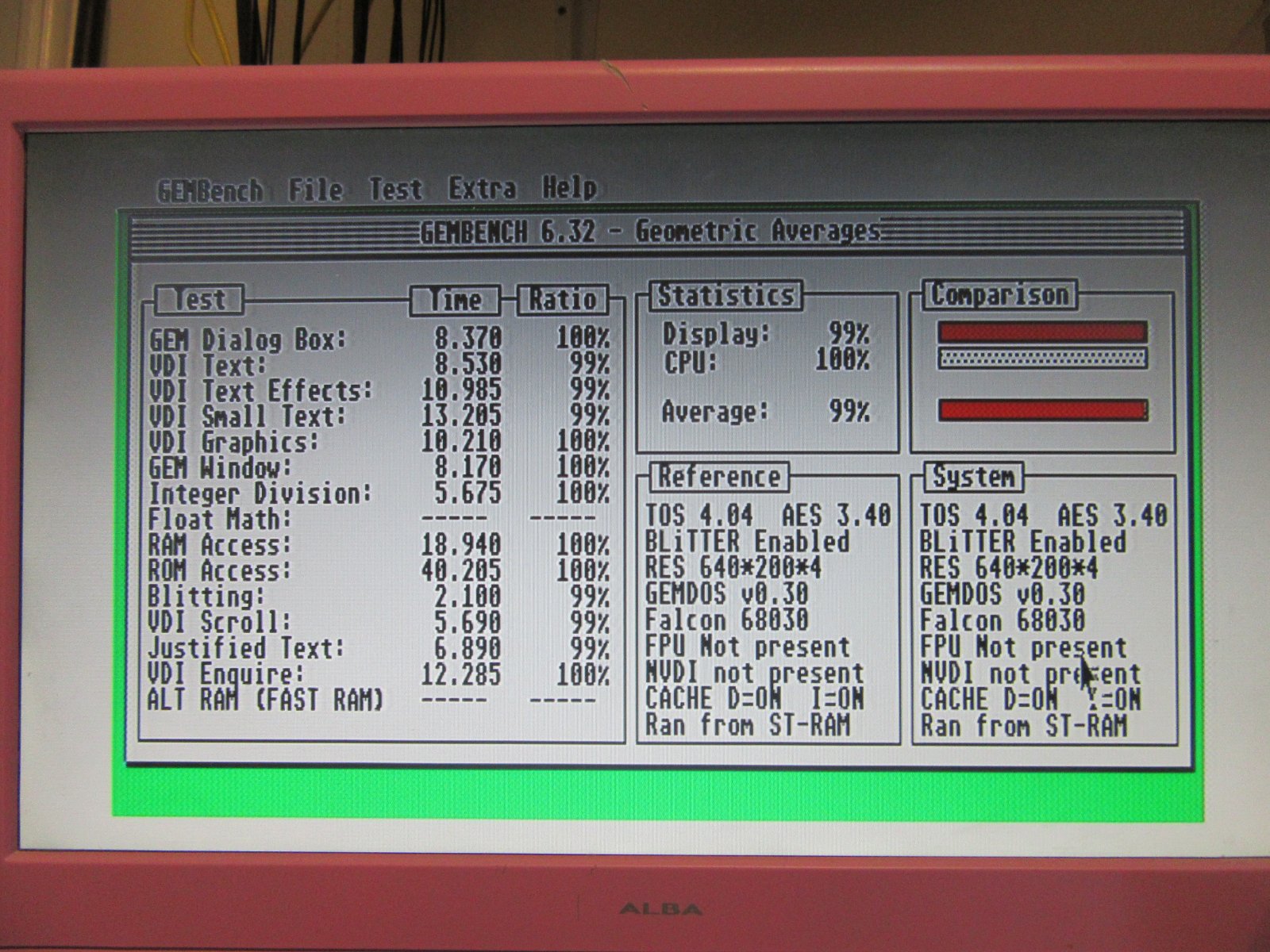

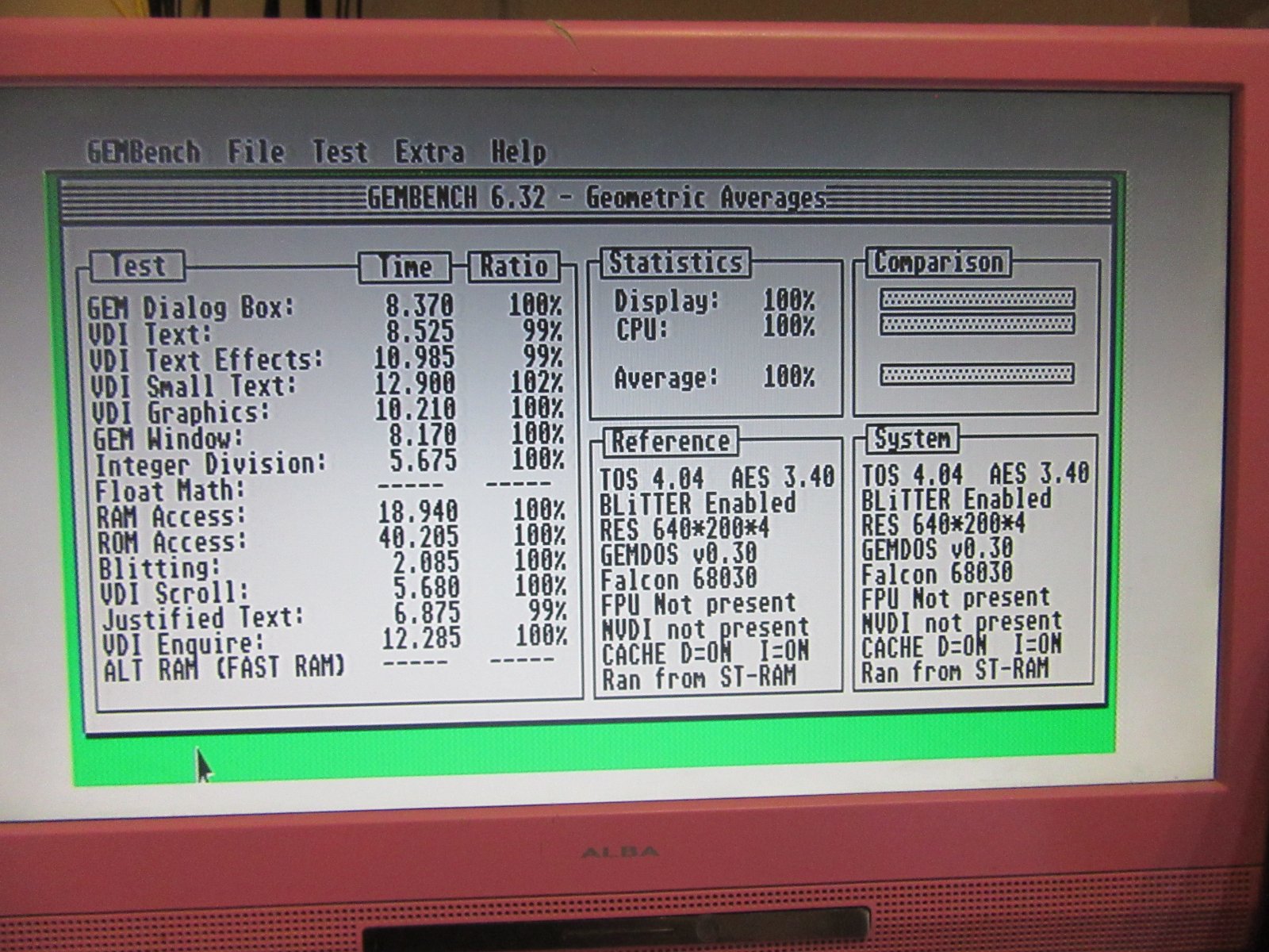

I've established a baseline first.
GB6 was calibrated first of all. Then a second run.
Then with DFB1X plugged in , jumper set to DISABLED.
So as GB6 depends on timer ticks, 1-2% variation is easily normal anyway.

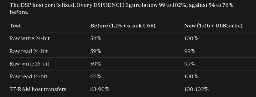

New firmware and new U68 U68turbo.jed.
DSPBench v3.0b - precision DSP tests. dml/2026
memory integrity test:
 DSP-local IX:IY $0000-$01FF march OK
 SRAM EX:EY $0200-$3FFF march OK
HOST interrupt test:
 RXDF/CPU interrupts triggered OK
 TXDF/CPU interrupts triggered OK
hostport raw R/W datarate:
 write ( 24bit x:H:M:L )   -> 3.603 MB/sec (~100%)
 read  ( 24bit x:H:M:L )   -> 3.015 MB/sec (~99%)
 write ( 16bit -:-:M:L )   -> 4.380 MB/sec (~99%)
 read  ( 16bit -:-:M:L )   -> 3.330 MB/sec (~100%)
host transfer rate (STRam)
 TX ( 24b/packed )         -> 2.441 MB/sec (~100%)
 TX ( 24b/longs )          -> 2.107 MB/sec (~100%)
 RX ( 24b/longs )          -> 2.198 MB/sec (~100%)
 TX ( 16b/words )          -> 2.360 MB/sec (~100%)
 RX ( 16b/words )          -> 2.767 MB/sec (~101%)
 TX (  8b/bytes )          -> 1.792 MB/sec (~102%)
 RX (  8b/bytes )          -> 1.872 MB/sec (~101%)
ALU & SRAM speed:
 mac ( P:Int X:Int Y:Int ) -> 16.000 Mips (~100%)
 mac ( P:Int X:Ext Y:Ext ) -> 8.000 Mips (~100%)
 mac ( P:Ext X:Int Y:Int ) -> 16.000 Mips (~100%)
 mac ( P:Ext X:Ext Y:Ext ) -> 5.333 Mips (~100%)

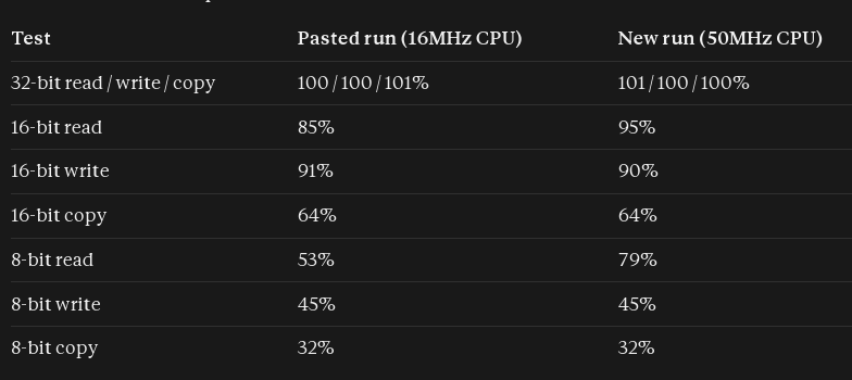

NemBench v2.2 - precision CPU/FPU profiler.
Integer multiply (16bit)      -> 1.921 Mips (~313%)
Integer divide (16bit)        -> 1.135 Mips (~313%)
Linear (stalled) integer      -> 24.899 Mips (~312%)
Interleaved (piped) integer   -> 24.899 Mips (~312%)
Float multiply (64bit)        -> 0.839 MegaFlops (~316%)
Float divide (64bit)          -> 0.543 MegaFlops (~313%)
Linear (stalled) float        -> 1.625 MegaFlops (~304%)
Interleaved (piped) float     -> 1.742 MegaFlops (~327%)
16bit read (100% cached)      -> 24.600 MByte/sec (~313%)
16bit write (100% cached)     -> 6.060 MByte/sec (~100%)
16bit copy (100% cached)      -> 4.995 MByte/sec (~83%)
32bit read (100% cached)      -> 49.140 MByte/sec (~313%)
32bit write (100% cached)     -> 6.711 MByte/sec (~100%)
32bit copy (100% cached)      -> 6.702 MByte/sec (~100%)
Linear 32bit read (ST-Ram)    -> 5.371 MByte/sec (~101%)
Linear 32bit write (ST-Ram)   -> 6.495 MByte/sec (~100%)
Linear 32bit copy (ST-Ram)    -> 3.257 MByte/sec (~100%)
Linear 16bit read (ST-Ram)    -> 5.064 MByte/sec (~95%)
Linear 16bit write (ST-Ram)   -> 5.851 MByte/sec (~90%)
Linear 16bit copy (ST-Ram)    -> 2.095 MByte/sec (~64%)
Linear 8bit read (ST-Ram)     -> 4.233 MByte/sec (~79%)
Linear 8bit write (ST-Ram)    -> 2.925 MByte/sec (~45%)
Linear 8bit copy (ST-Ram)     -> 1.044 MByte/sec (~32%)
Feed it all into AI for the round up. Someone else can check it :)

exxos wrote: Wed Oct 28, 2026 9:39 pm New firmware and new U68 U68turbo.jed.
Wow, that's a great result, all looks really positive.
Is this the work of Pakman, BW and yourself? Thanks to you all! 💪
Posts: 29604
Re: Slow DSP investigation with DFB1
viking272 wrote: Wed Oct 28, 2026 10:30 pm Wow, that's a great result, all looks really positive.
Its @Badwolf and @Pacman work. I only tested it.

I'd presume the new U68 would fix the DSP issue on the CT60 as well..?
