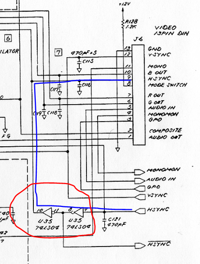

Just to illustrate that I'm not imagining things, here are the buffers for HSYNC from an ST schematic from dev-docs:
I'm afraid it does not work that way. As I've said before (also applies to the TT): "If you input sync signals with different timing than the ST would produce itself, it does not work."Cyprian wrote: Tue Feb 16, 2021 6:20 pm Below is VESA standard for similar pixel clock 31.5 MHz but with different horizontal and vertical timings.

Yes, assuming you use an ST without buffers and you switch the sync pins on the GLUE to input before connecting the cable. I still wonder, though, what this is supposed to achieve.Cyprian wrote: Tue Feb 16, 2021 6:20 pm Back to my question and my schematic, whether is it safe from electronics point of view?
