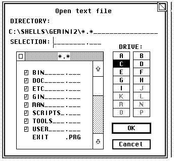

8.4.2 fsel_exinput
Name: »File selection extended input« - Select filenames.
Opcode: 91
Syntax: int16_t fsel_exinput ( int8_t *fs_einpath, int8_t *fs_einsel, int16_t *fs_eexbutton, int8_t *elabel );
Description: The call fsel_exinput makes a system file-selector dialog box available in which the user may choose a complete GEMDOS path specification. It may also be passed a title-string that is to appear in the file-selector (normally indicating the action the user is about to take).
The function can be passed the following parameters:
Parameter Meaning
fs_einpath Name of the default access path (absolute) with appended search mask; after the call it contains the new pathname
fs_einsel Name of the default file; after the call it contains the newly selected filename
fs_eexbutton Exit button:
0 = 'Cancel' was selected
1 = 'OK' was selected
fs_elabel Titelzeile
Notes: The function should be nested with wind_update (BEG_MCTRL or END_MCTRL) to prevent double-clicks being passed on to underlying windows.
fs_einpath points to a character buffer at least 128 bytes long (200 bytes if CD-ROMs are to be accessed). fs_einsel points to a 13-byte buffer (12 for filename characters plus a terminating NULL). fs_elabel points to a buffer up to 30 characters long.
Return value: It is imperative that the return value of the function (0 = error) is respected, as a shortage of memory, for instance, may make it impossible to use a file-selector.
Availability: This function is available only from AES 1.4 onwards.
It is also present in FreeGEM. To check for this feature, use appl_init and check that xbuf.arch is non-zero.
If it is available, it should be used rather than the fsel_input call, as with the latter the user is not reminded what the function is actually doing.
