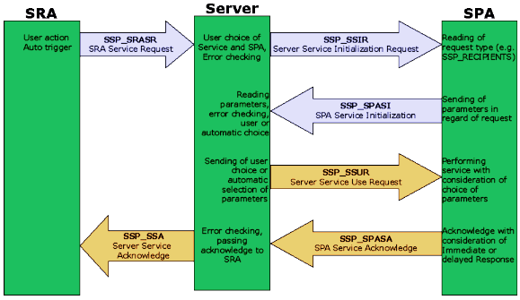

Messagesare currently undefined. Free AES message numbers have to be found and the SSP messages defined.
Service Requesting Application Service Request
#define SSP_SRASR 0x126F SRA -> Server AES message-buffer: [0] = SSP_SRASR [1] = appl_id - Application ID of SRA [2][3] = (long)dataLen - LONG that gives length of data in the shm-block [4] = dataID - Data identification (SSP_TEXT, SSP_FILENAME ...) [5] = shmID - ID number for shared memory file Filename for shm-file is u:/shm/[applid]_data[id].ssp For example, if Smurf has appl_id 25, is sending a file and chose id 0: u:/shm/25_data0.ssp
| SSP_COMPRESSFILE: | Complete Filepath, including name and extension |
| SSP_SENDFILE: | Complete Filepath, including name and extension |
| SSP_UPLOADFILE: | Complete Filepath, including name and extension |
| SSP_SENDMSG: | Complete text message to be sent |
Server Service Initialization Request
#define SSP_SSIR 0x1270 Server -> SPA AES message-buffer: [0] = SSP_SSIR [1] = requestID - ID of Server request (SSP_RECIPIENTS, SSP_COMPRESSFORMAT...) [2] = sessionID - ID of SSP session Filename for shm-file is u:/shm/[applID]_init[sessionID].ssp
Service Providing Application Service Initialization
#define SSP_SPASI 0x1271 SPA -> Server AES message-buffer: [0] = SSP_SPASI [1] = sessionID - ID of SSP session as given in SSP_SSIR
#define SSP_SSUR 0x1272 Server -> SPA AES message-buffer: [0] = SSP_SSUR [1] = serviceID - ID of service (e.g. SSP_SENDFILE) [2] = sessionID - ID of SSP session as given in SSP_SSIR [3][4] = (long)initID - ID of picked initialization datum [5] = shmID1 - ID 1 for shm-block [5] = shmID2 - ID 2 for shm-block [7] = sspPar1 [8] = sspPar2
| SSP_COMPRESSFILE: | Complete filepath, including name and extension |
| SSP_SENDFILE: | Complete filepath, including name and extension |
| SSP_UPLOADFILE: | Complete filepath, including name and extension |
Service Providing Application Service Acknowledge
#define SSP_SPASA 0x1273 SPA -> Server AES message-buffer: [0] = SSP_SPASA [1] = sessionID - ID of SSP session as given in SSP_SSIR
#define SSP_SSA 0x1274 Server -> SRA AES message-buffer: [0] = SSP_SSA [1] = dataID - ID of data shm file as given in SSP_SRASR
The services are not directly requested by the SRA, but determined by the Server, from the data identification provided by the SRA in messagebuf[4] when sending SSP_SRASR.
SSP_SENDFILE - Send File Service
Interactive IRS
Used to make a networking application send a file to a destination
(user).
Upon sending of the SSP_SRASR message from the SRA to the Server,
the shared memory block will contain a NULL-terminated filename for the file
to be sent. dataID has to be SSP_FILENAME.
The Server will request SSP_RECIPIENTS from the SPA with SSP_SSIR.
The SPA then has to provide a shared memory block that contains a list
of possible recipients separated by CRLF terminated by NULL with the
SSP_SPASI message. The Server will open a list of the recipients for
the user to choose from.
The SPA will then receive a SSP_SSUR message containing the number
of the recipient from the list in ssp_par1 (messagebuf[6]).
The shared memory block will contain the NULL- terminated filename of
the file to be sent.
The SPA concludingly has to send SSP_SPASA to the Server, to close
the session.
The Server will send SSP_SSA to the SRA, indicating the service is
in progress and the shared memory file can be closed and deleted by
the SRA.

There will be no SRA-side timeouts. Timing out will be handled completely on the Server side, because a) the SRA doesn't know about Immediate or Delayed Response Services, and b) depending on the SPA that might have to be started first, startup time may screw up SRA- side timeouts. Besides that, it takes even more work off the SRA's back ;)
Timing out between SSP_SRASR and SSP_SSA will be done by the SSP- Server, with consideration of startup times and IRS/DRS cases. The amount of time before a service times out will have to be determined once the first Server implementations and protocol implementations on application side are done. Approximately 3 to 5 seconds after possible startup of the SPA should be sufficient for IRS.
The Server will check all errors it can (nonexisting or empty shm- files, etc.). If an error during a session occurs, the Server will send SSP_SSA to the SRA to make sure the shm-file gets closed, and then report the error in an alert box. Timeout for delayed response services will depend on the type of service and on Server-side determinations. For example, If the SPA knows an error occured, it can send an error-message instead of SSP_SPASA. Still, in case of a crash of the SPA, a timeout has to be implemented.

Every arrow is one AES message. This makes clear that there are only 2 messages (send one, receive one) to handle for the SRA, and only 4 (send 2, receive 2) for the SPA. The majority of the work is done by the SSP-Server. The communication is a request-response scheme, where every message has a response from the messages' recipient.

Communication Session
Make sure you understand the concept of SSP SPA-sessions. A
session between an SPA and the Server is started with the SSP_SSIR
message, and ended when the SPA sends SSP_SPASA. For every SPA there
will only be one session at a time. Multiple service requests by SRAs
will be queued, and sent one after another. This might be changed in
future implementations because of not being able to perform another
service while a session is active, which is a drawback in case of
Delayed Response services.
1. Receiving Service Initialization Request and determining the information
type
The SPA (your application) will receive the SSP_SSIR message to
indicate use of a service your application provides. The Server knows
the services provided by your application from the Server

2. Initializing the service and providing information
2.1 Creating a shared memory file
The information the Server has requested is sent by your
application in a shared memory file. Whether one has to be created or not
depends on the serviceID. There is a unique name for every
shm-file used for each service request, the name of the file is built
by the following conventions:
For example, if your application has appl_id 25 and
sessionID is 0:
u:/shm/25_init0.ssp

2.2.2 Sending Service Initialization
Send an SSP_SPASI message to the Server, filling the AES
message- buffer with the following values:
[0] = SSP_SPASI
[1] = sessionID
sessionID(messagebuf[1])
The session ID sent to you with SSP_SSIR.
3. Receiving Service Use Request
When your application receives SSP_SSUR, this means that a service
should be performed now.
messagebuf[1] will contain the serviceID also received in
SSP_SSIR. This makes it possible for you to keep initializing and
performing services separate from one another. The serviceID
will be the same throughout one session.
messagebuf[2] will contain the same sessionID as in
SSP_SSIR.

4. Performing the Service and acknowledging
4.1 Performing the Service
Depending on the parameters sent in SSP_SSUR you can determine
what to do. Ultimately the way your application performs certain
services is up to you, and also depends on the type of your
application. See 'Guidelines for performing services' for a general
direction to go to.
4.2 Acknowledging
Acknowledging a service is done by sending SSP_SPASA to the
Server. When you do this depends on your application and on the type
of service (IRS or DRS). With Immediate Response Services, you should
start performing the service (e.g. open a connection to a user and
start sending a file) and acknowledge before the service is actually
finished.
With Delayed Response Services (e.g. the Compress File Service)
acknowledging should not be done before the service is completely
performed (e.g. the files are compressed).

15.10.13 Glossary
SRA
Service Requesting Application. This means the application that
sends SSP_SRASR to the Server to request use of a service.
SPA
Service Providing Application. This means the application that
receives SSP_SSIR from the Server to indicate that an SRA has
requested a service. All SPAs have to register with the SSP-Server.
Service
is a certain part of an applications functionality or
capability that can be provided to, and used by, other applications
using SSP. Generalized types of services are hardwired into the
SSP-Server. See SSP services.
IRS
Immediate Response Service. This means a service that requires
virtually immediate response to SSP_SSUR from the Server, with
SSP_SPASA.
DRS
Delayed Response Service. This means a service that requires
response to SSP_SSUR from the Server with SSP_SPASA not after
performing the service has started, but after performing the service
has been completed (e.g. compressing files).
Invisible Service
This means a service that is usually triggered automatically by
the SRA without requiring user interaction. See Status Display Service.
Interactive Service
This means a service that is usually triggered by the SRA from
a user action. See Send File Service.

Server
or SSP-Server Application running in the background
that receives and sends messages from and to SPAs and SRAs. All
communication between SPAs and SRAs has the SSP-Server as mediator.
See What is the SSP-Server?
Message
in these documents refers to an AES message received by
evnt_mesag (or evnt_multi, respectively). The communication in SSP is
based on AES messages.
See SSP messages.
