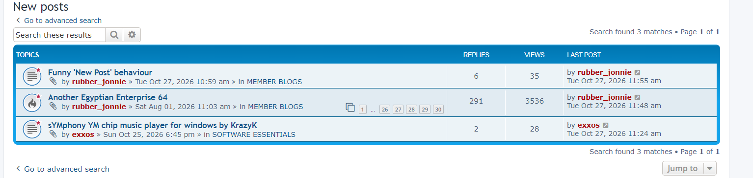

Posted: 27 Oct 2026 11:49
by exxos
This is what I currently see and read posts are still in list about three hours later.
Re: Funny 'New Post' behaviour
Posted: 27 Oct 2026 11:54
by rubber_jonnie
exxos wrote: 27 Oct 2026 11:47

exxos wrote: 27 Oct 2026 11:49 This is what I currently see and read posts are still in list about three hours later.
That matches what I see, but by now it would usually have cleared.
Posted: 27 Oct 2026 13:13
by exxos
and now..
Posted: 27 Oct 2026 13:33
by rubber_jonnie
exxos wrote: 27 Oct 2026 13:13 and now..
Same for me.
