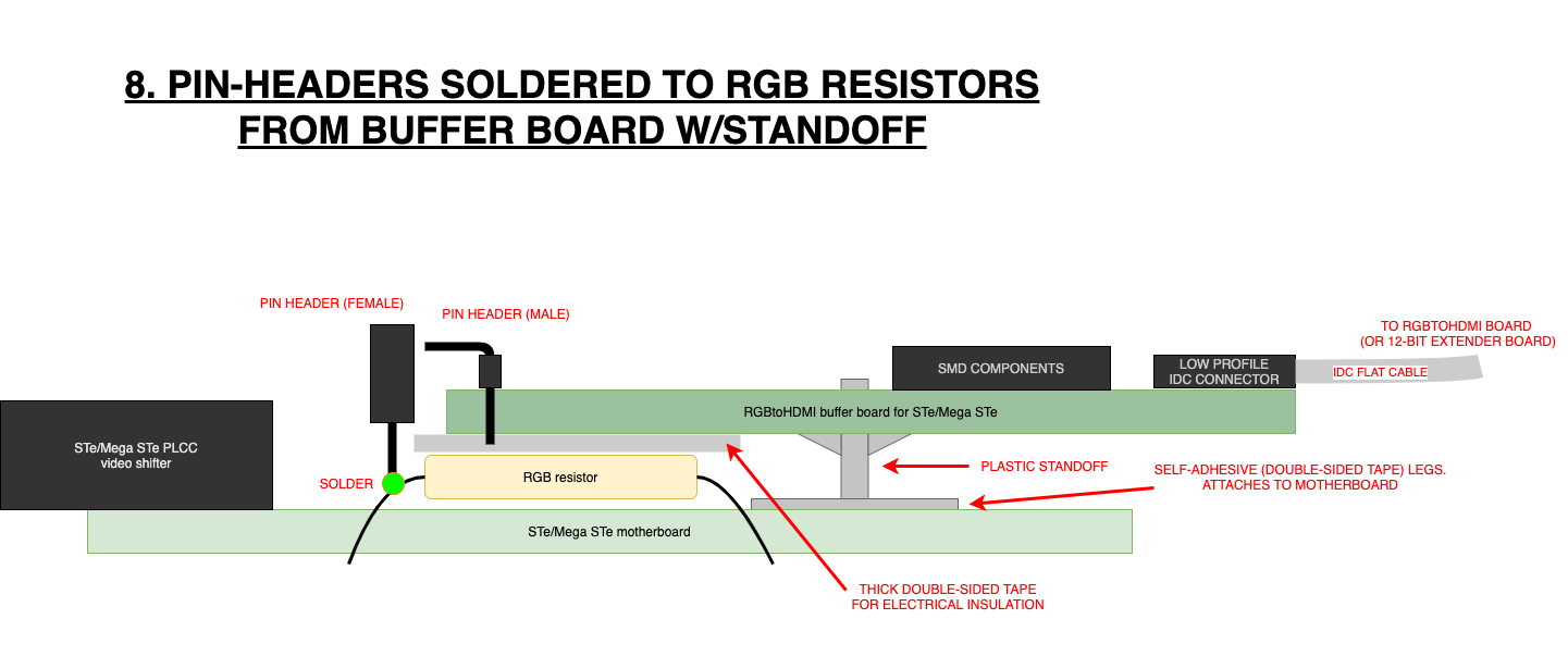

@DoG: I think the plastic standoffs with adhesive legs could work! :D
8. pin-headers soldered to RGB resistors from buffer board with standoff.png
8. pin-headers soldered to RGB resistors from buffer board with standoff.png (87.98 KiB) Viewed 20 times
The standoffs (two on the right side of the buffer PCB will probably suffice) would take care of a secure mounting plus raise the buffer PCB above the RGB/mono resistors and prevent any short circuiting from through-hole components from the buffer board (and some thick double-sided tape to the top of the RGB/mono resistors would add extra electrical insulation, cushioning and additional fastening).
This and the use of pin headers for connecting the board to the RGB/mono resistors would make for a clean, easy to replace/repair/remove modification :)
Obviously I'd have to make some measurements first as it's a tight fit in the STe, but with multiple heights of standoffs to choose from I think there's a good chance this will work out. In worst case, the IDC header connector will have to be mounted on the bottom side of the PCB. I'll have to look into what kind of options I have, but I think there are a few IDC connection options to choose from.
