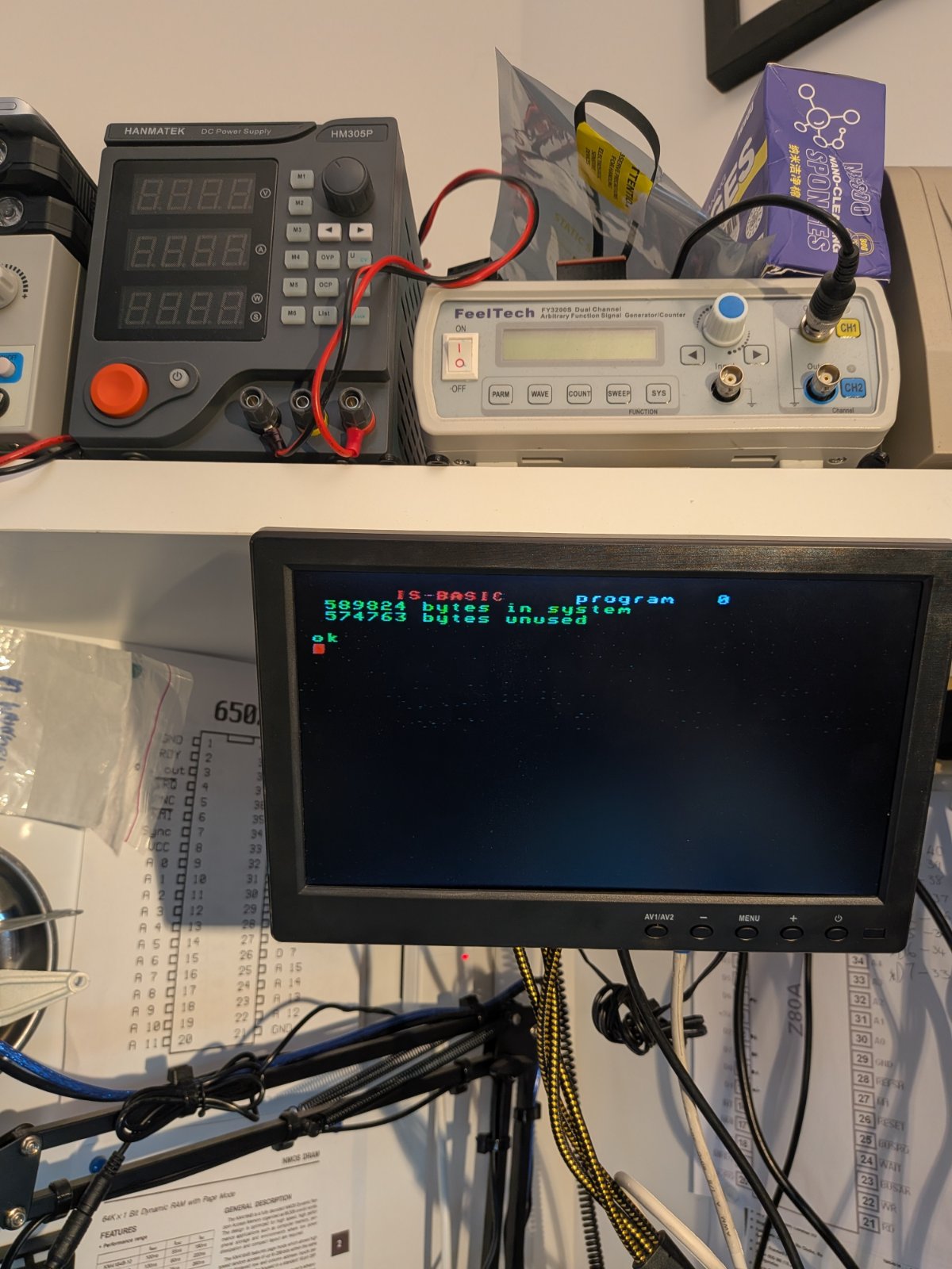

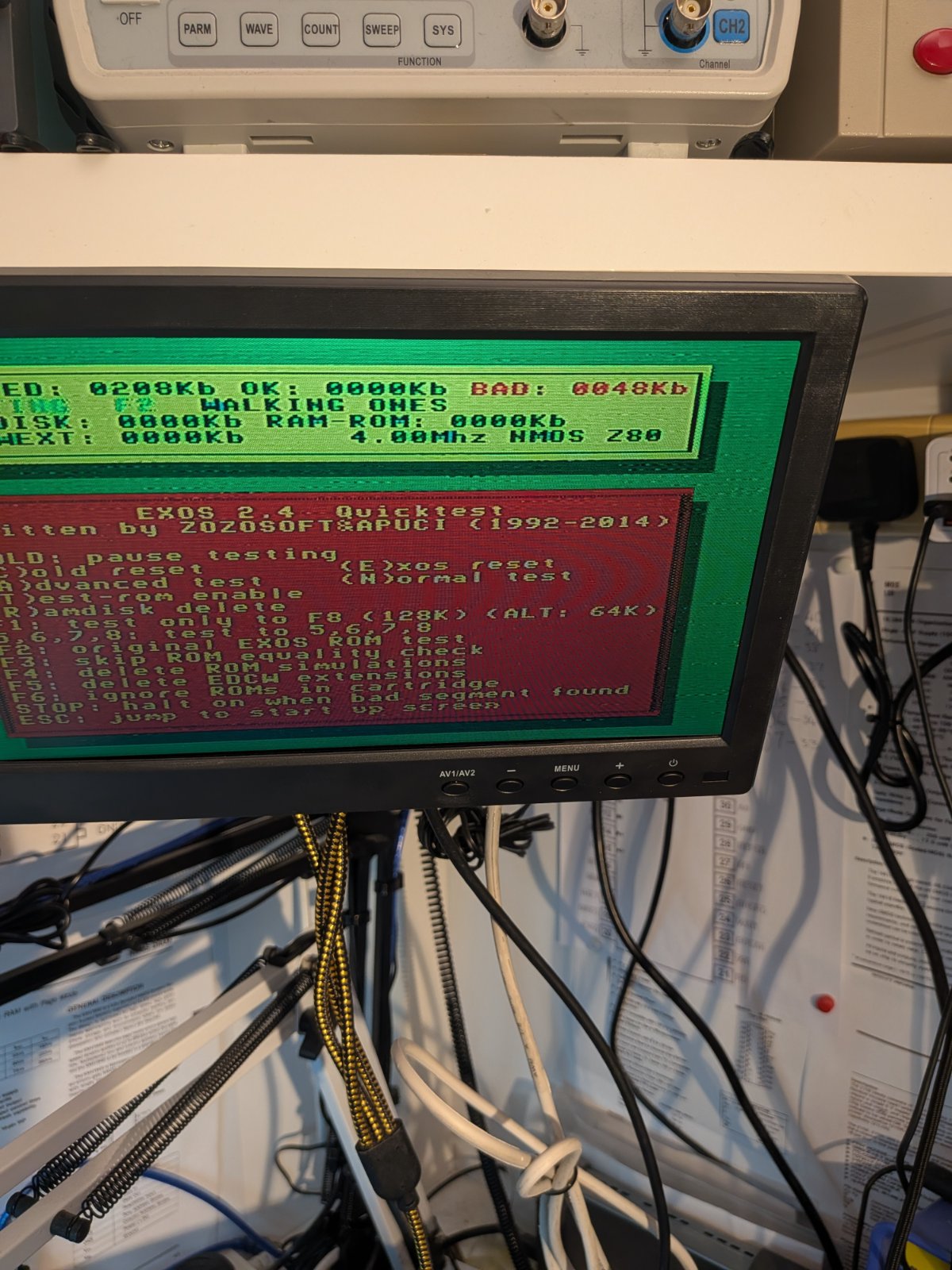

OK so I have more RAM.
Only one small issue:
So like my other machine it may need a replacement CPU, either that or the RAM is bad. At least I know what the fix was last time and I can easily get more RAM, having spares is always useful

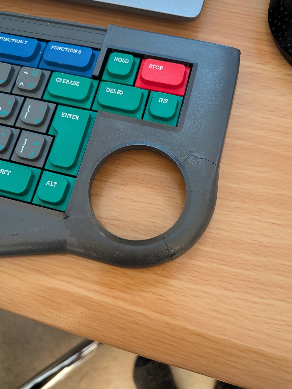

The case is now looking a bit more together as well:
So all I need to do now is add some reinforcement behind in the form of UV resin and thin GRP strips and it should be good for another round trip to Egypt...

It’s a little suspicious that two machines have the same issue with the RAM expansion. Maybe the timing is very close to the edge and variations in the CPU timing per chip is enough to allow it to work or not.
I seem to remember that the Z80 in the Enterprise is an SGS part, which probably has a different mask to the Zoloft version and hence probably different timing.
- Posts: 15537
Re: Egyptian Enterprise 64 number 2
Can't recall the make in the new machine, but fairly sure it's not the same as the one from the other machine. I will pull the CPU first I think and try the CMOS Z80 I have from one of my SBC's before I go ordering any more memory.stephen_usher wrote: Tue Oct 20, 2026 7:03 pm It’s a little suspicious that two machines have the same issue with the RAM expansion. Maybe the timing is very close to the edge and variations in the CPU timing per chip is enough to allow it to work or not.

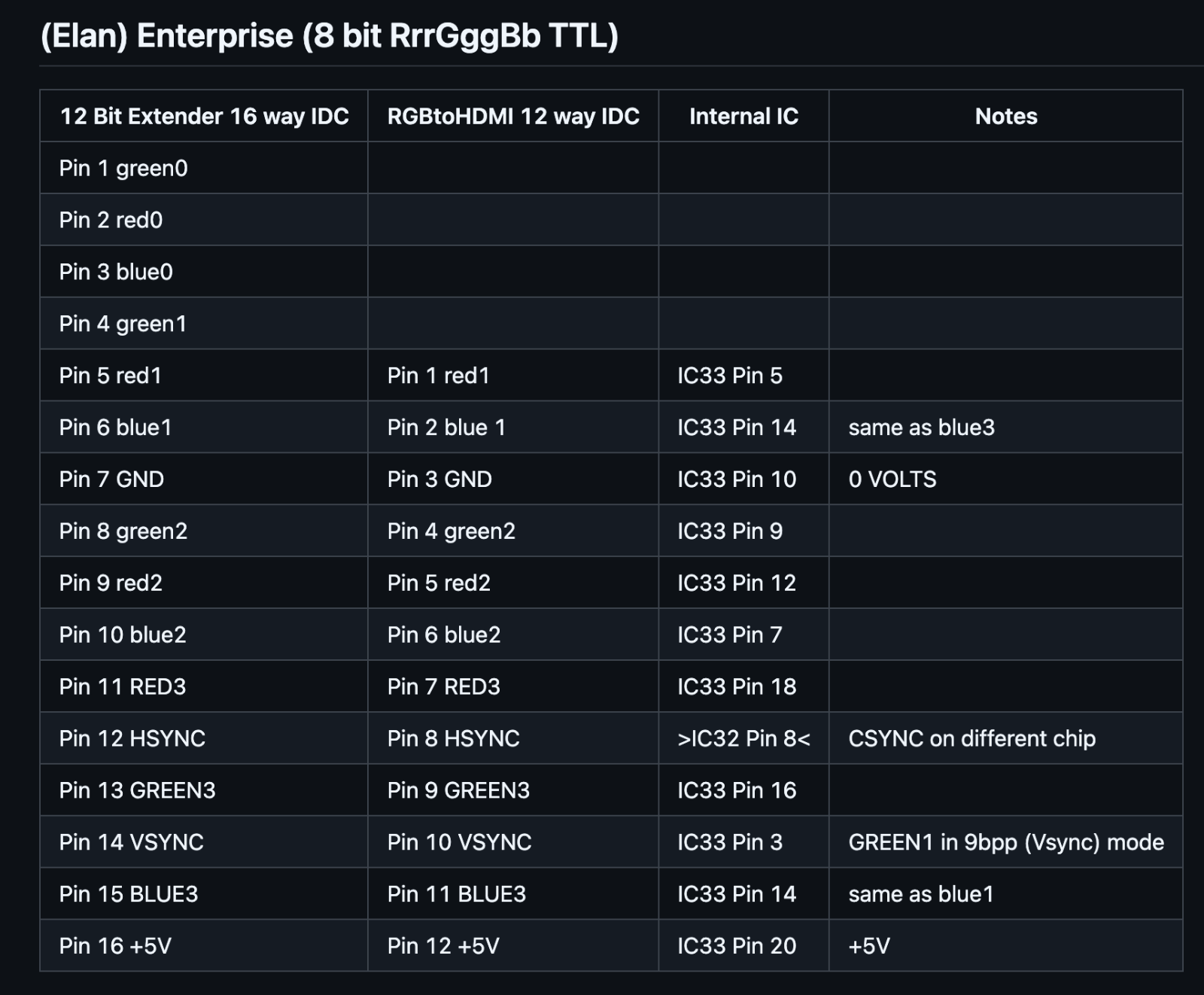

I'm planning to try hooking this machine up using RGB2HDMI, though its practicality may be questionable since it requires wiring internally to 2 ICs.
I'd like to try whilst the mainboard is out on the bench though. Anyway here is the wiring:
Taken from here: Wiring guides for RBG2HDMI
I'll report back when tested.
