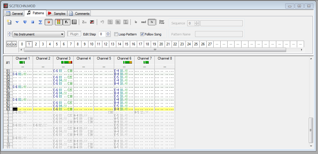

Hmmm.. now to do a 8 channel one :twisted: Can a STE play 8 channels.. no idea :lol:

STe regularly used to play 5 channels in menus and title screens. Four samples mixed in software into one HW channel plus the other HW channel.
Not in-game as it eats too much CPU time
Plus you can use the YM PSG at the same time

Its hard to remember there was a 8 channel tracker on the STE, I used my Falcon a lot back in the day, so likely was one there.
True - but not exactly true. Putnik redid xenon to play DMA sound direct from harddisk. It only took a couple % CPU time.

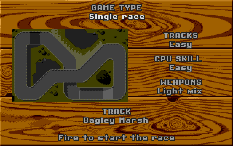

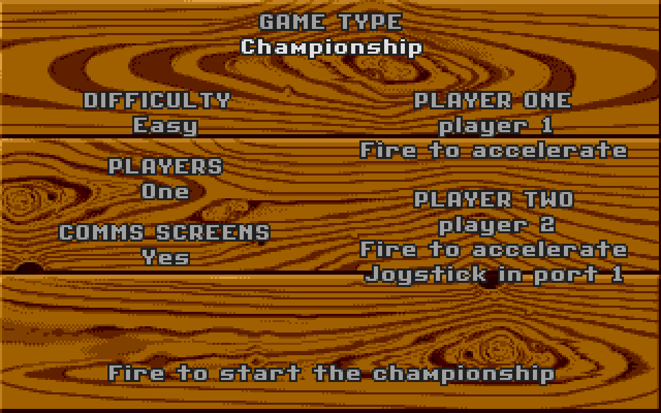

New menus now working :)

Two channel fixed frequencies like ppera's HDD streaming are practically CPU free on STe. Only have to program the DMAs
But a tracker requires lots of software resampling on STe because unlike Paula it can only play back at a handful of frequencies. Nor more than 2 channels (e.g. 4 channel tracker requires software channel mixing).
