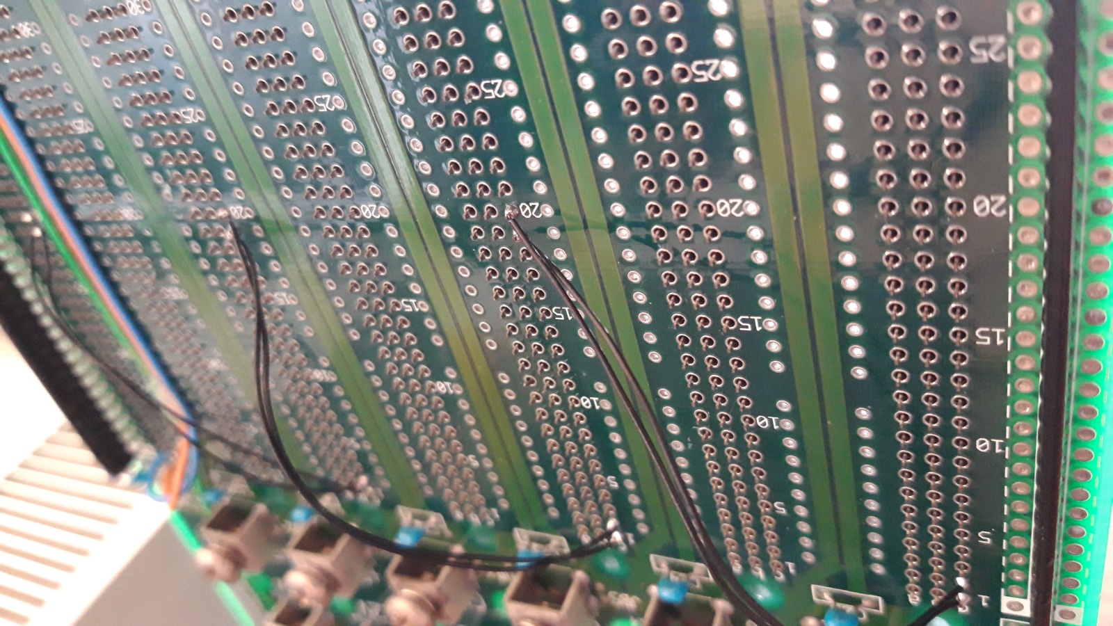

So I figured out which points on the backplane expose the up/down links in my topology diagram. I knew they were exposed there, just had to identify them exactly.
Unfortunately the pins are too short to attempt wirewrap so I just soldered them.

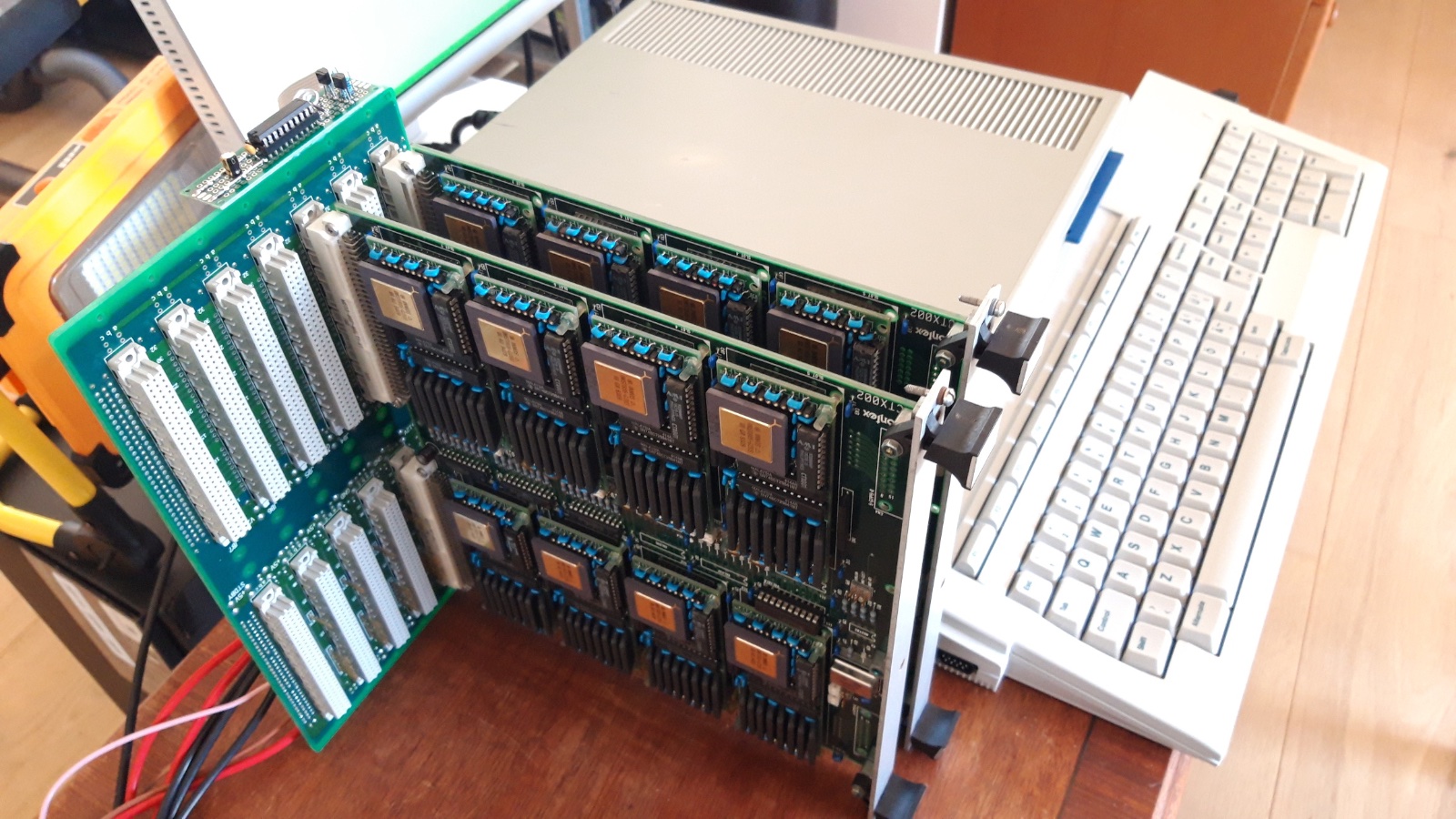

Two boards now installed on the backplane:

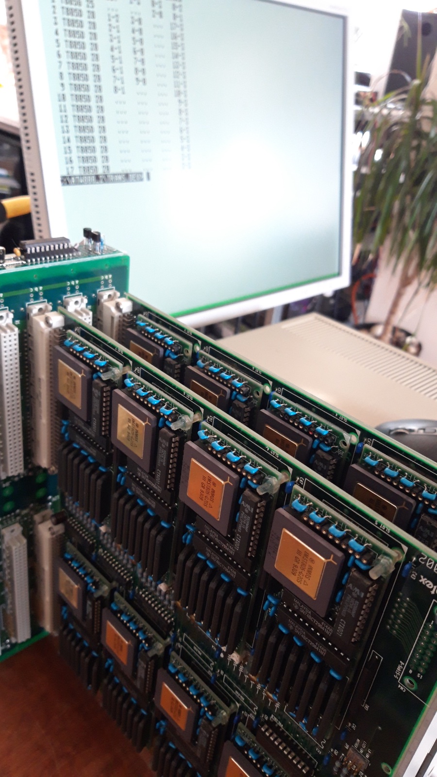

Two boards detected and ready to go:

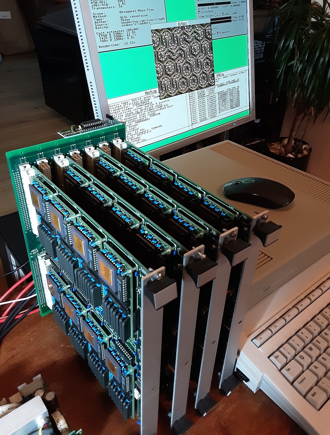

So this is the final thing, sort of. It doesn't have a box though.
It's a bit precarious but it runs.
