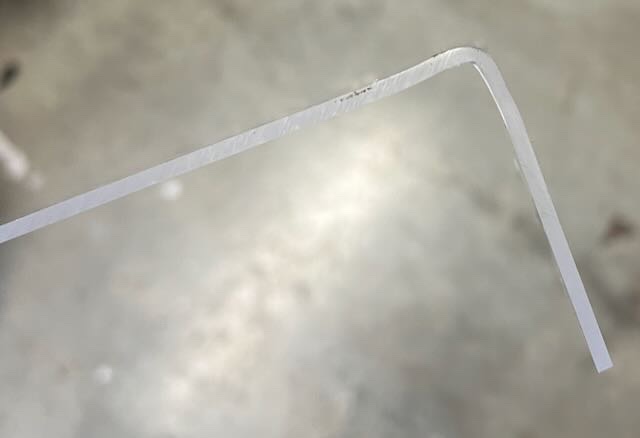

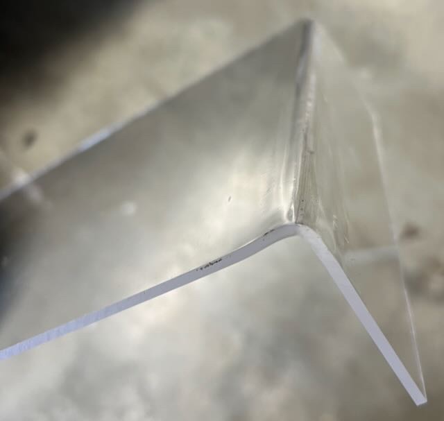

So first attempt. Not bad but angled and a bit wonky.
Kept going with that bit after having a second attempt at it (an advantage of acyclic sheet is the you can reheat it and try again it seems). 2nd bend got to hot and blistered a bit.
New sheet went better although I found that pressing to hard can leave dents from what your pushing it against (my old workbench)

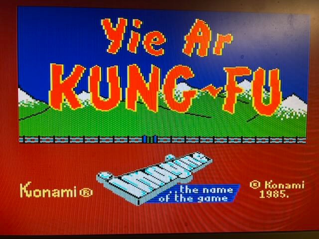

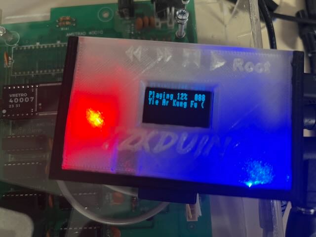

A power switch and tape input connections have been done but so far no luck in getting something to load, might need an amplifier to boost the signal maybe? I don't have any tapes and my tzxduino reloaded v1.4 with maxduino v1.51 firmware doesn't want to play a CDT file so have been trying with a windows machine and a Samsung tablet. closest I got was to get a filename recognised and otherwise just get read errors.

Refreshed my TZXduino with tzxduino v1.18 firmware to replace the maxduinoq and it now plays CDT files ok

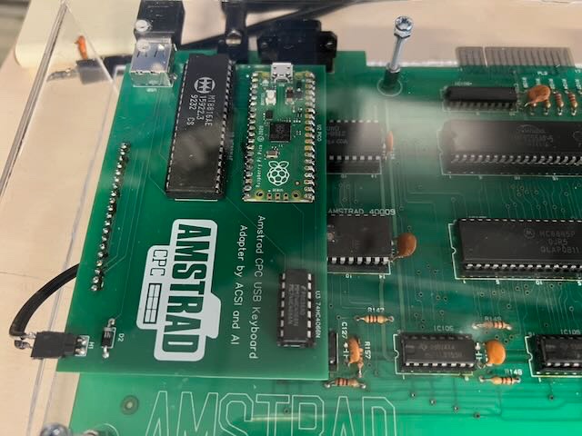

My first ever PCB and of course I completely forgot to take into account the case screw which needed to be removed but it works
