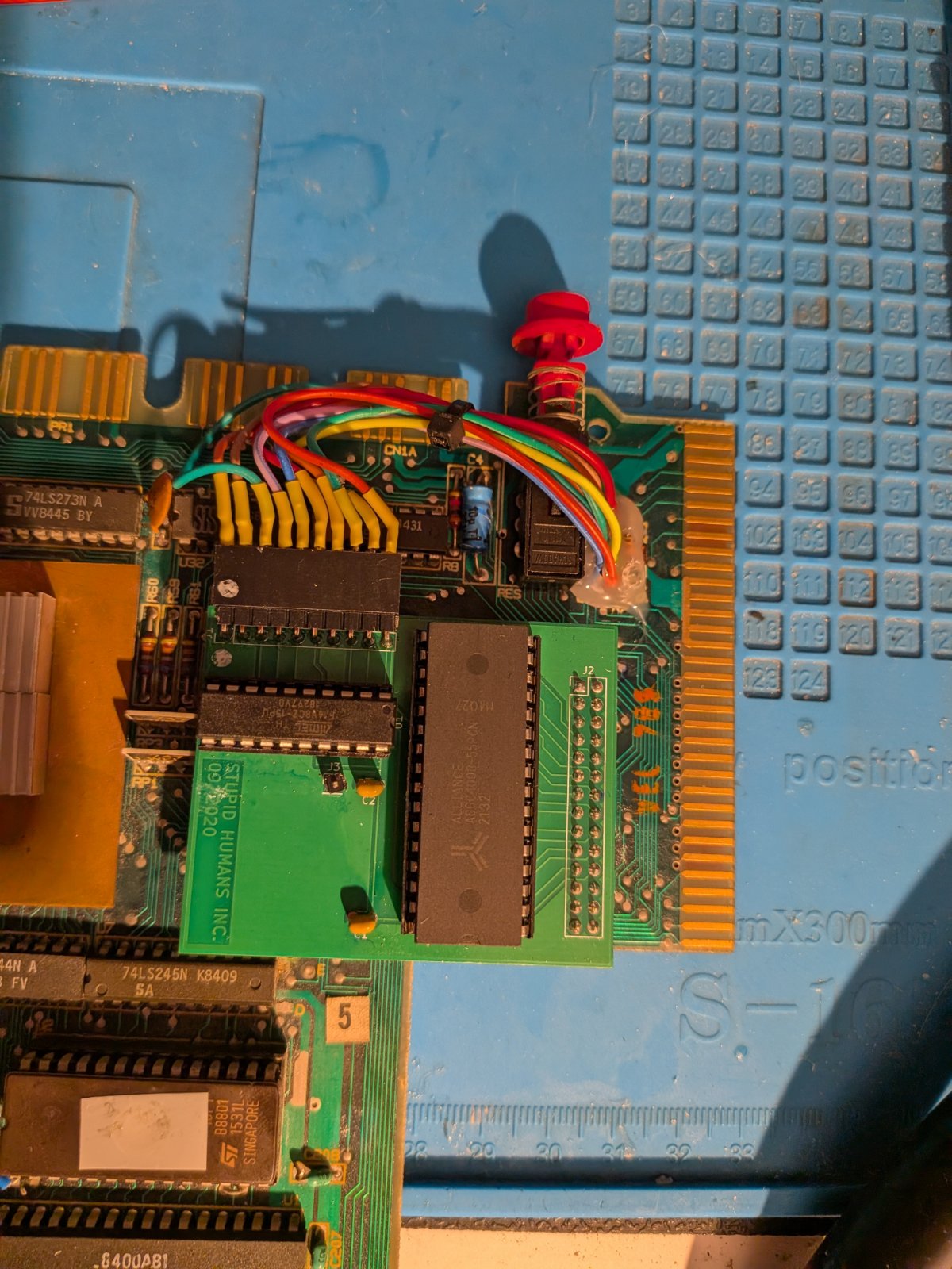

OK, gratuitous shot of the final install of the RAM board.
I ultimately made a plug for the smaller expansion header and soldered the leads directly to the mainboard with a hint of hot glue for strain relief.
All working fine, so I need to get the machine reassembled now and properly test.

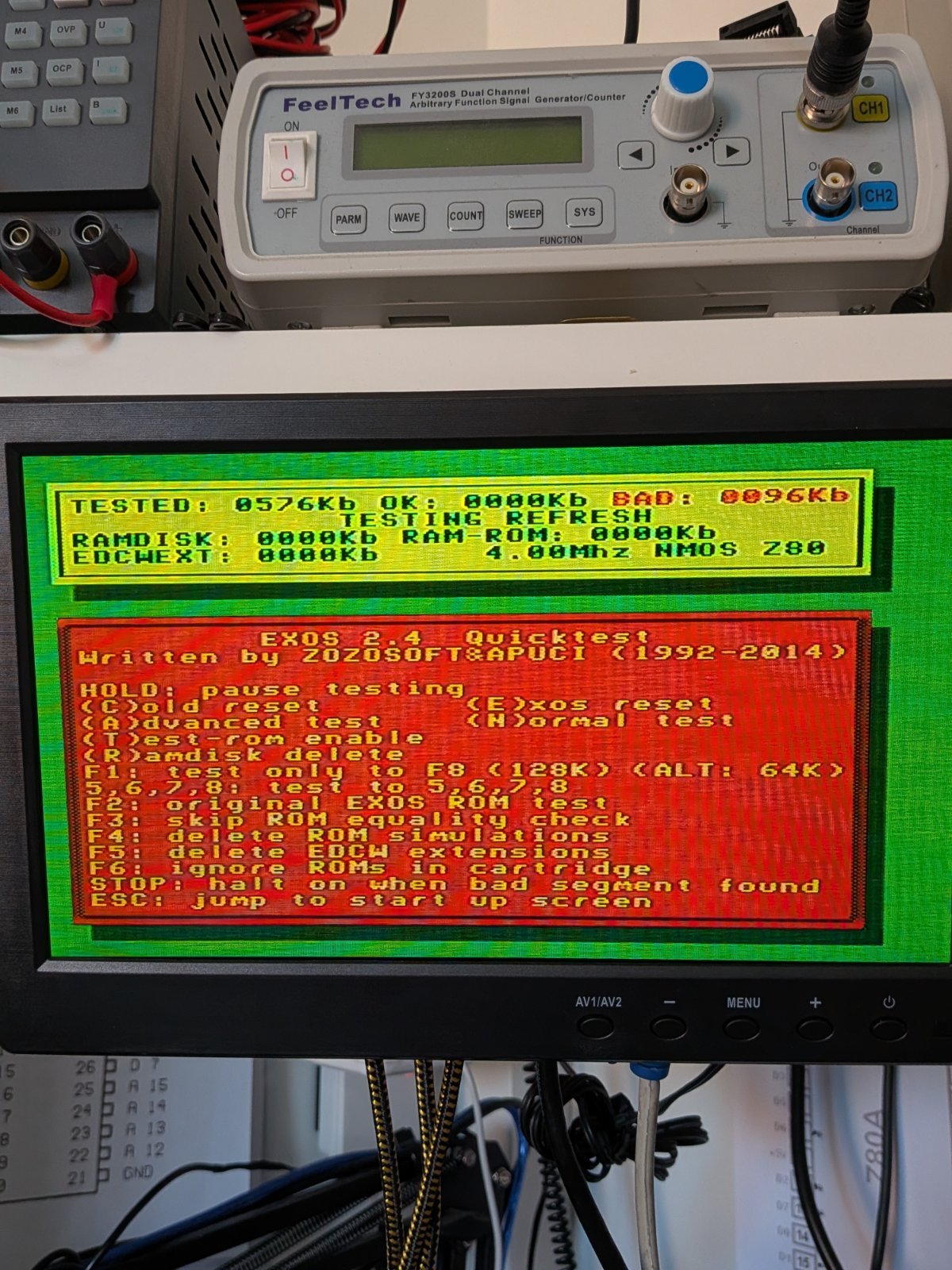

OK, so I think the RAM IC is bad.
I left it running a simple for next loop printing to screen earlier and it crashed. It was a pretty interesting crash, and I should have taken a pic.
I did it again and it crashed with a black screen, not nearly as interesting...
So I ran the full memory check (It passes the simple one) and get this:
So I've ordered a replacement IC as my own smaller capacity spares don't work in this boards. We'll see how it goes when that arrives.
- Posts: 7577
Yeah, looks like the static RAM isn't very static. Definitely not Scotch as it fades away.
