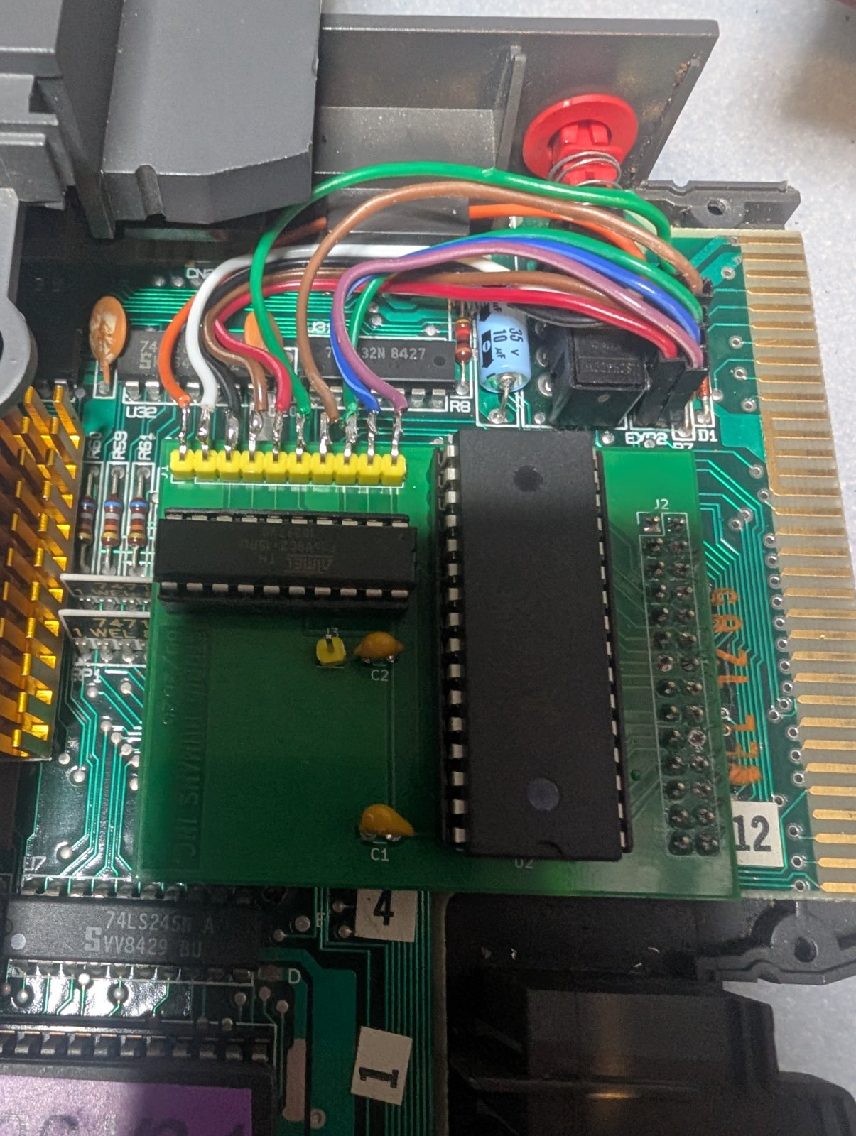

@rubber_jonnie I didn't use a jumper afaik.
Here's the pic of my install if it helps. You do have the upgraded tom installed as well right?

Note that with the DuPont connectors on EXT2 you'll have trouble putting the case on as there's no enough clearance. I soldered the wires on, as Enterprise did for the 128.
I agree, that's why I bent the headers on the ram board over and then soldered the wires on.stephen_usher wrote: Mon Sep 21, 2026 5:36 pm Note that with the DuPont connectors on EXT2 you'll have trouble putting the case on as there's no enough clearance. I soldered the wires on, as Enterprise did for the 128.
- Posts: 7604
It's more the side of the case doesn't have enough clearance between it and the EXT2 holes on the motherboard.

I have EXOS 2.04 installed with the lifted leg/bodgewire mod. Is that what you're using? When I boot the test screen prior to the flashing Enterprise logo it states 64KB good and 512KB bad, so either a RAM issue, connection issue (I connected as per here: Connection guidePhilC wrote: Mon Sep 21, 2026 5:23 pm @rubber_jonnie I didn't use a jumper afaik.
The Stupid Humans GitHub stated the wiring was the same.
I will cross check mine against yours.
