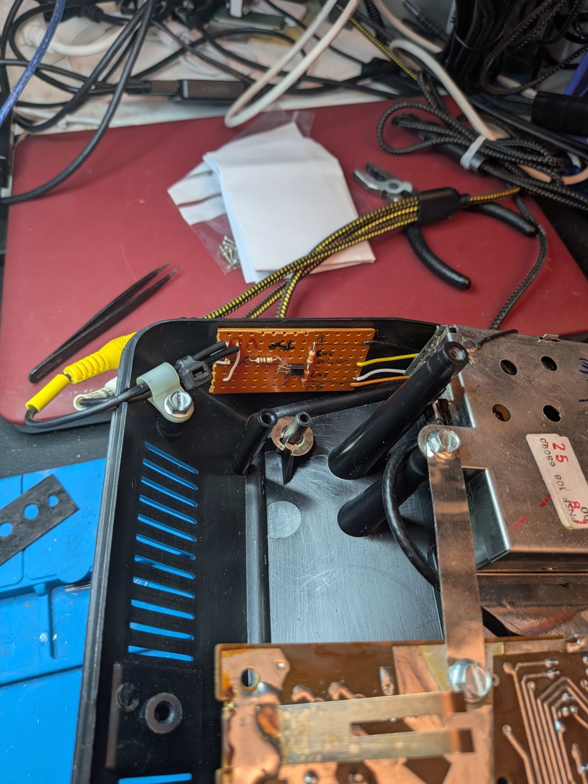

OK, so nearly there. Small veroboard composite mod with sound is done and installed:
I've reused the original UHF cable hole and strain relief (Plus a cable tie for extra security), so no case mods and fully reversible. The original (Very long) mudulator cable is tucked inside the case:
And all is running great, so time to test the joysticks and then chuck the bottom of the case back on.

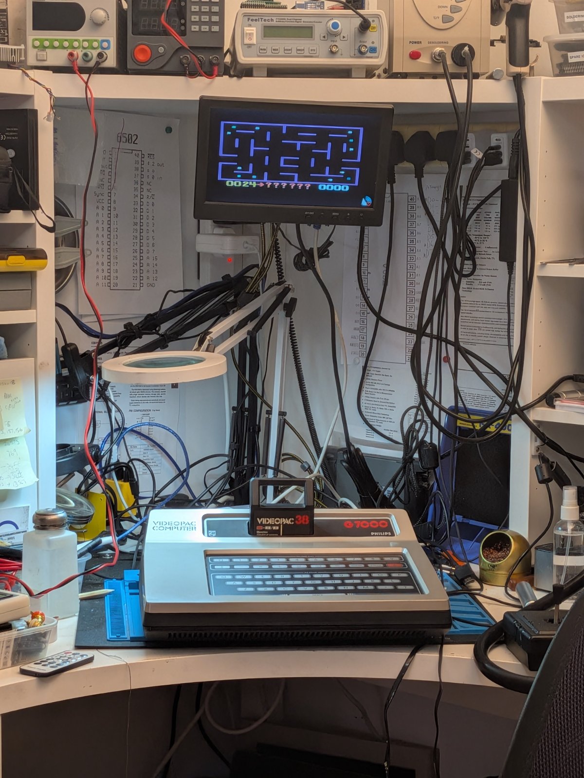

And - it's finished!!!
All back together and both joysticks work perfectly. The throw is a little long but they are decent for the time.
Also the game - Mucnhkin. It's a surprisingly good Pacman clone with lots of game variations, such as walls that vanish when you move and reappear when you stop, plus ever changing mazes and mazes that change each time and a maze builder.
Seems to be better than the 2600 for the time ('78') but was only really successful in Europe. Oddly I don't recall seeing 2600's in the stores here, though I do recall seeing the Videopac.
Pretty pleased with it
