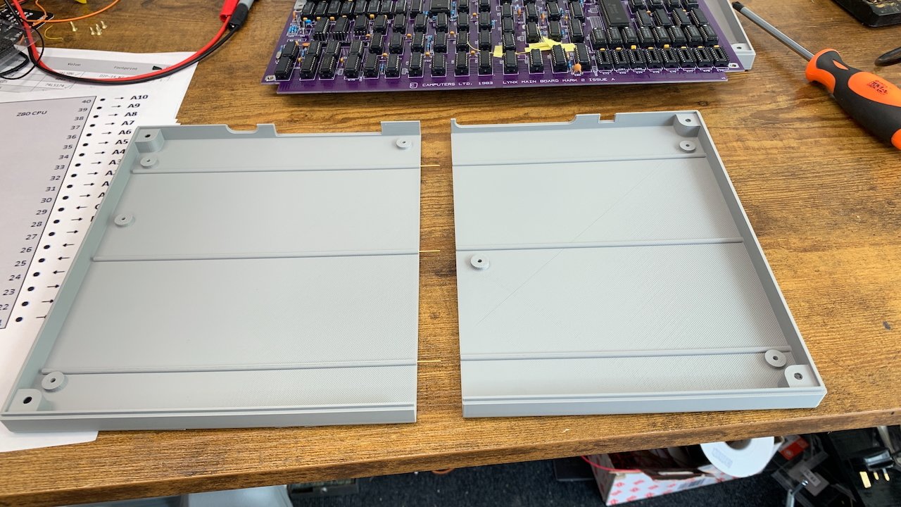

Seeing as I can't get further with the electronics until the 74S series chips arrive next week I've been working on designing a 3D printed case.
So far I've got the lower half done, other than a minor miscalculation for the DIN port position. I can fix this in Fusion but the current print is good enough for now. I'm using 1mm brass rod to help join the two halves.
I've also been designing an upper case and the first draught is printing now. Though as I've effectively run out of grey filament it's going to have to be brown for the time being. The print is going to take over 10 hour and use a quarter of a kilogram of filament. It's got the same port issue as the lower one as I didn't notice this until after I'd started the print whilst I was putting the lower half together.
The one electronic thing I did do yesterday was change back to using a 5V input and installing a DC-DC converter board to generate the 12V. These things are so cheap! I bought 10 of the boards for ~£7 off Amazon. I had to add a 100uF cap on the output to suppress the switching spikes but other than that they do a good job. Unfortunately the "3A" 5V PSU I bought at the same time isn't well regulated. About 5.7V unloaded but as soon as its connected to the computer, which is drawing about 1.2A, the voltage drops to about 4.8V. At least it's clean with imperceptible ripple.

Nice neat solution there Stephen. Did you copy the original case or design your own?

I'm using photographs for reference plus the PCBs then designing the case to be as close to the original as I can.PhilC wrote: Fri Apr 10, 2026 4:42 pm Nice neat solution there Stephen. Did you copy the original case or design your own?
