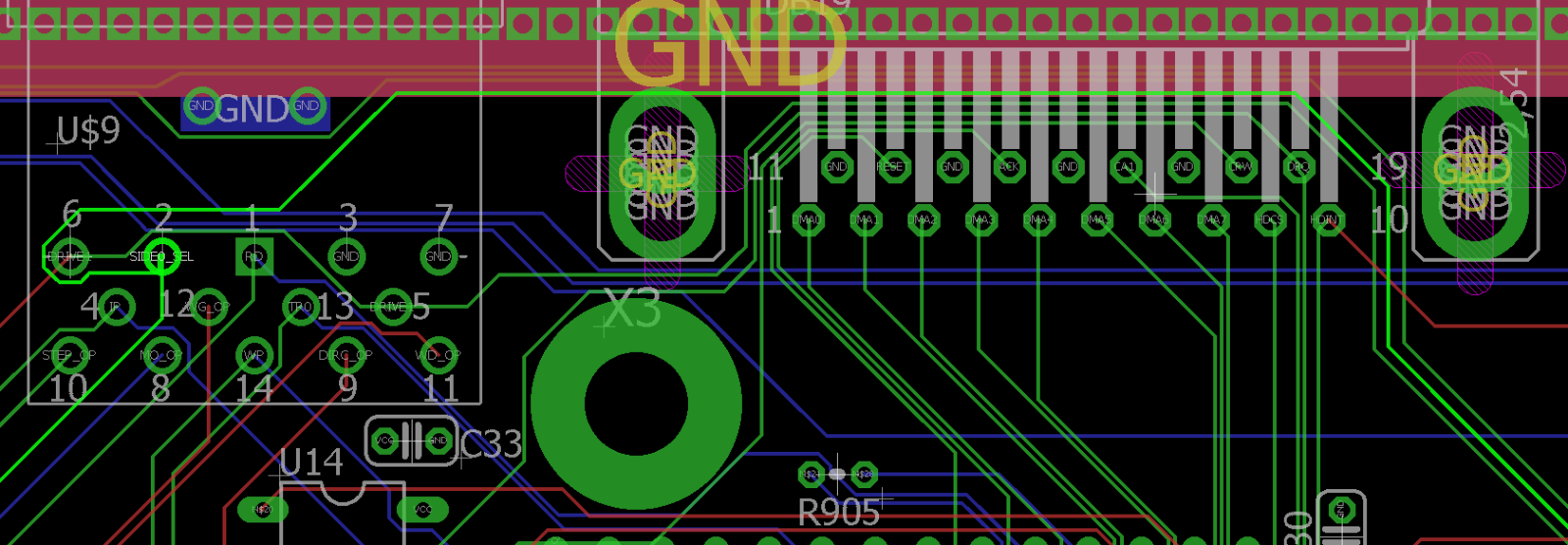

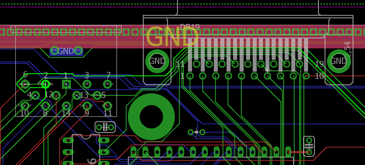

Should not have any faults after all the revisions. I don't remember what your referring to, can you give me more information and I'll check the files.
Posts: 29651
Re: Kodak80 H4F build
Oh I see the problem,
Version F
Version F1 - looks like I made the DB19 holes longer to fit various connectors and even though the track was moved, it still managed to short out :roll: :cussing: :headbang:
