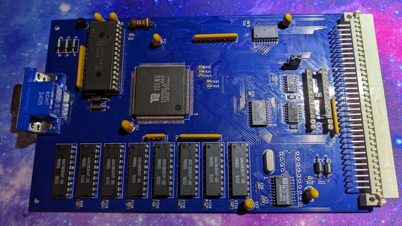

Finished building :) I just need to program the GAL.
GAL files: https://www.newtosworld.de/viewtopic.ph ... 1dabf0414b

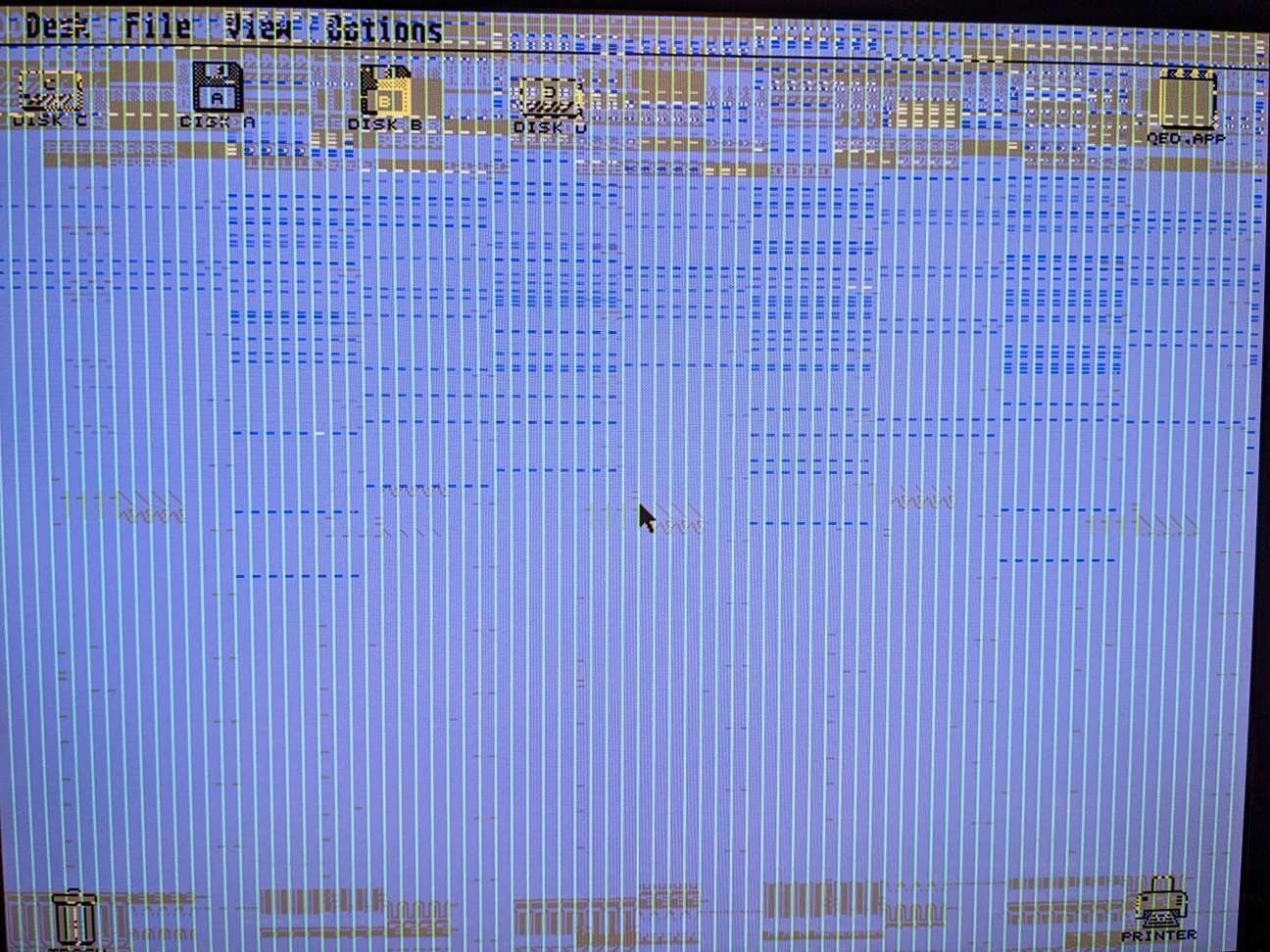

I just wanted to report, this project was a fail.
At first it was not working at all, I would just get bus errors when loading the driver. I then spoke to Artic-wroc who agreed to look at the card. I posted the card over to him (internationally) in the mean time, Frank Lucas found a fix for this old ET4000 IC (mine was the older variant) which required lifting 3 pins and soldering them to ground. Artic linked me to this fix and proceeded to just post the card back to me almost immediately - I asked him "Since I've sent it to you, could you not lift these pins and test it for me before sending it back?" He ignored me and just sent it back.
I get it back and after de-cyphering what pins to lift (I say de-cyphering because Frank only gave address lines, not pins.) So I read the data-sheet and (hopefully) lifted the correct pins and soldered them to ground. (I say hopefully because the datasheet was quite confusing, I think it only specifically listed two of the pins that I needed and the other had to be an educated guess) Nobody on the forum (Atari forum) would/could confirm if I'd chosen the right pins (41, 42, 43 and GND to 45)
(The Atari forum thread is here: https://www.atari-forum.com/viewtopic.p ... 98#p478598 )

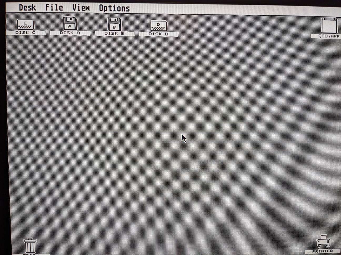

Anyway - I went through testing various different PAL files, I found the Super_4K seemed to work and produce a mono image upon loading the driver. When choosing colour (any colour, any res) it would be a garbled display. Idek tells me that since the card displays mono OK then it isn't a vRAM issue, since et4000 uses the same memory for mono and colour.
(I did try different drivers, mainly V3 and V8 based on Franks recommendation)
I very frustrating experience overall. I haven't given up but I'm planning on swapping this old et4000 IC with the later varient when I get my hands on one.
It can't be too far off working... here's the screenshots:

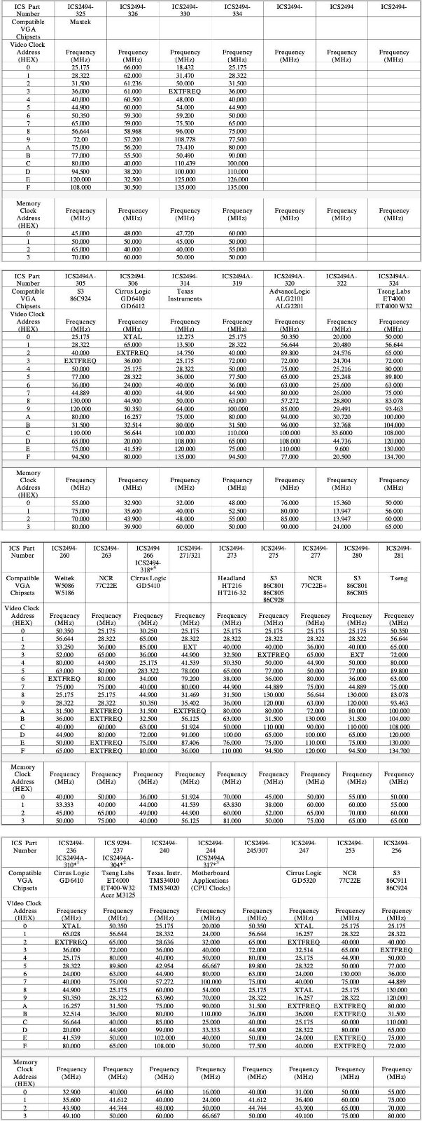

You must be the right Clockgenerator chip ...! Have you a right one?
